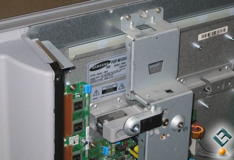

Postby jklillibridge » Tue Sep 23, 2008 6:45 pm
I'm a bit of a novice so I appreciate everyone's help. I have a voltmeter, which terminals am I pointing to and how exactly do I do it? Here is a photob below. I see the white screws to adjust each, just having difficult reading voltage. Also, what settings should my voltmeter be on, AC 200V?

Postby martini161 » Tue Sep 23, 2008 6:53 pm
is it possible to get a higher resolution photo? and what are the availible settings on your voltemeter?
