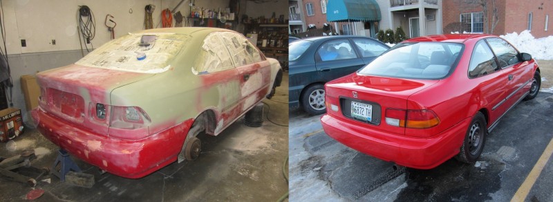

Not sure if any of you guys are car nuts, or car audio nuts, but here's the (long) skinny: I have a '97 Civic DX that I got this past fall with 120k on it, that I got for a cheap commuter because I was strapped for cash and my '93 Sable with 240k wasn't exactly keeping up with my 80mile+/day commutes (head gasket, and massive steering problems) so anyway, the civic had hit a deer and a large branch fell on the roof ontop of the rear driver pillar, so I decided to do basically a ground-up rebuild and repaint as it did need a number of things in addition to paint that looked 100x worse than the Sable. so into our garage it went, for a while. I only had time to work on it on the weekends, but when it started getting colder it was harder and harder to keep the Sable running (checking antifreeze and oil every morning and afternoon) so I rushed the paint a bit. or a lot. Normally I would have my dad do most of the work and I assist. but for several weeks before the Paint was on and for a month or two after my dad was across the country with my mom for work. so I had to do it myself if I wanted to drive it before New Years (the build started in September and I finished paint the last week of October)
I actually painted the car on Sat. oct 27th and drove it home to my apartment at about 11pm on 28th to drive it to work that week, with many things non completed and various issues (no dash lights due to mis-wiring the new Sony Xplod GT240 stereo I ripped out of the Sable), some exterior trim missing, paint all over the gaskets around windows and on the tires and door panels off among many others
but here is how she stands today right after a car wash finally after ~2months:
mid-build & after:
front bumper cover replaced, and pass. fender
