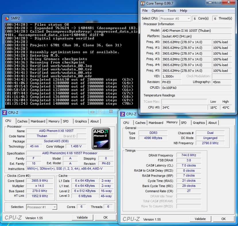

any guesses as to the temps?
1055T 3.9GHz 1.5v
48C load 27C idle with the dual-fan, lapped H50
dual fan on the lapped TRUE, fans on fan controller set pretty quiet
-Austin

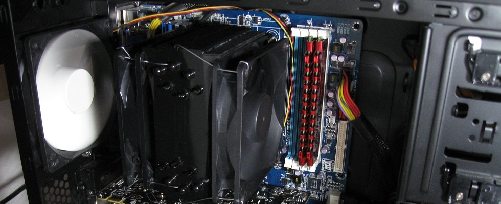

no guesses? alright, the true loads at 42C with a moderate fan profile, 38 or so at max fan speeds, idles at 20-22C
i'd say a very nice improvement, it runs colder and a lot quieter than the H50
with the window cracked last night:
-Austin
