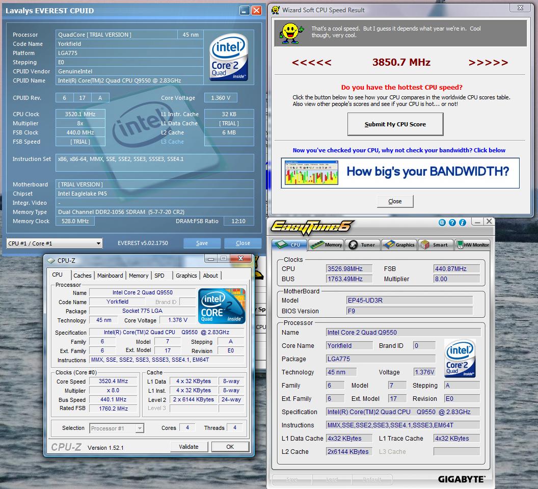

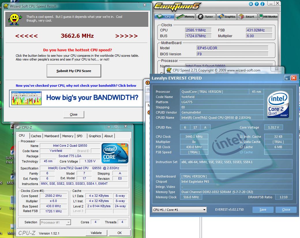

I looked high and low for Intel's performance killer but could not find it anywhere in the BIOS. I have Award BIOS with GB's Tweaker. I even tried EasyTune 6 to bring it up to 3.2 and here are the results from all utilities I have--EasyTune, Everest, CPU-ID, and CPUspeed:
I don't know what to believe anymore.....4 utilities, 4 different clock speeds.
All utilities.jpg (174.63 KiB) Viewed 6394 times

Go to the BIOS section Advanced BIOS Features and disable CPU EIST Function. To see if speedstep is the culprit here put a load on the CPU and open up CPU-Z and see what it says.
ibleet
Posts: 1529
Re: My "new" rig
Post by ibleet »
Major_A wrote:Go to the BIOS section Advanced BIOS Features and disable CPU EIST Function. To see if speedstep is the culprit here put a load on the CPU and open up CPU-Z and see what it says.
Also look for "C1E" (enhanced halt state) in the bios.
Thanks a million, ibleet and Major_A. Since I disabled those two functions in BIOS I'm getting consistent speed readings on 3 out of 4 utilities (one I think just makes up a number) and my rig's operation seems much more "crisp," for want of a better word. Apps are launching quicker, FF even seems to be much quicker than it was. I almost feel like I need to slow my mouse down. Or I could just be getting old.
It seems pretty stable at 3.5 so I'm going to let it run for a few days as is and see if any anomalies rear their mutant little heads. Man, this thing seems quicker. Switching between apps is almost scary quick.
Thanks again guys,
Jack
