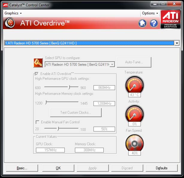

Ok, so... I've busted the case open and place a fan in front of the whole damn computer (which fits almost perfectly btw. I could almost bolt the fan to the chassis, paint it black make the part)
The computer has been running on desktop for 3 hours, it's maintained a steady 43 - 44 degrees and there has been no shut down :) ! It's got to be a temperature thing, right? Like i said, i could run the Graphics cards under load playing Clear Skies under maxed settings, and the PSU had no problem maintaining power (although there was a lack of expected performance in game - which i'll get into another time).
But for now i want to make sure i can manage the temperature. I dove into catalyst ATI Overdrive and at the end of the three hours running on desktop this is the temperature reading:
ATI overdrive temp reading.jpg (81.18 KiB) Viewed 13924 times
But I'm not sure which card it's reading. I can't say i'm too familiar with Catalyst. It's detecting Crossfire and the cards are being detected in the information center, but I'm not finding anything else detected under the drop down bar in the Overdrive menu.
Also, If a graphics card gets so hot that it shuts down the computer - what kind of damage could i have done to the card? I let it happen 4 or 5 times while blundering my way through trouble shooting. I Hope i haven't damaged anything [-o< .

Idle temperatures mean nothing. Fire up Firemark and report the load temperatures. As for high GPU temperatures causing the system to shut down, your GPU is probably doing fine.

What are your voltage readings using software? To me this sounds like a power supply issue. If you are getting video artifacting it could be that the PSU isn't giving them enough juice. Try HWMonitor and report back. This can also monitor temperatures. If it doesn't pick up your video card then GPU-Z will be able to.
Other things:
1) What driver version are you running?
2)Press the key in the OD panel to unlock it.
Screenshot of GPU-Z Sensor tab, if HWMonitor doesn't recognize the cards.

I've accessed the second card stat:
Temp - 0
Activity - 0
fan - 20%
So it's not being used, at least outside of gaming, which contradicts me about the overheating issue and may indeed be a voltage thing #-o. I had better at least take a meter to the PSU. The fan has obviously made a difference somewhere though.
So no probs. I'll run some software update drivers and get back asap :) .
