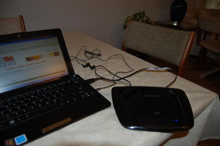

First, cut both the USB and the power adapter cable so that you have about 4 feet of cable total. Using scissors, a razor, wire strippers, or whatever sharp object is handy, strip both leads on the power adapter cable. Strip the leads on the segment of cable that has the socket that plugs into the router! Next, strip the outer rubber coating and the tin foil insulation on the USB cable away and expose the four wires inside. There should be a green, a white, a red, and a black wire. Strip the red and black wires. On the power supply cable, find which lead is positive, and which is negative. The positive should be indicated by a dotted line on one of the leads. Twist the red wire on the USB cable and the positive lead on the power supply cable together. Twist the unmarked cable on the power supply cable and the back wire from the USB cable together. Now, wrap electrical tape around each of the connections you just made. Fold the leads so that they are parallel to the cable, and wrap electrical tape around the entire connection site. The final product should look like the one shown below.
And there you go, hope this helps all who read this!
