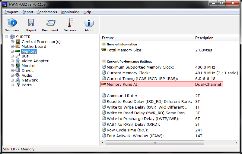

What other hardware is installed in the machine? The motherboard might not support dual channel mode. For more system info download HWiNFO32.

What does HWiNFO32 say about the Memory?

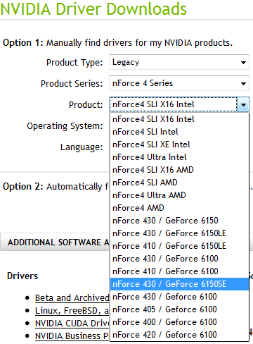

And you have the latest chipset drivers off of nVidia's site, correct? Sorry had to post a picture since I can't link to the file since I don't know what OS you're running.

I installed the drivers listed for the MB off of a Compaq support site. 15.49 nforce_win_vista_win7_32bit
