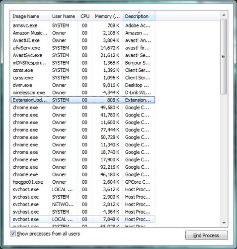

Here I am in South Texas, about the same distance from Mexico as I am from Canada at home. I'm using my brother's HP p6214y to rip a couple of his CDs to my phone when I discovered I can't make a new folder. Anywhere. I found a couple of scripts that allegedly create the necessary entries in the Registry but neither worked. One ran successfully but made no difference, the other claims (roughly paraphrased) "the keys are in use and cannot be modified". Same result in Safe Mode.
Computer Properties claim this is 32-bit 7 Ultimate SP1 but I've never seen Task Manager look like this (See below) There are no tabs at the top of the window and no way to make them appear that I could find. There is also no way to close the window other than to end the taskmanager process or close it from the taskbar.
I also got a couple of core dumps for my trouble. So I'm off to run some diagnostics.
Brief specs include Athlon II X4 620; 8 GB RAM (only 3.25 usable of course); 1 TB WD HDD.User account is Administrator
Any ideas aside from reinstalling OS?
Thanks, as always,
Jack

double click the edge of the task manager window to see the tabs again - that white space on the left before the edge of the whole window and the internal box with the tasks listed.
Try rebooting in safe mode and see if you can create a folder. It may just be something simple like the user account had the permissions turned off.....

Thanks! Should've known it would be something obscurely simple!!
Apparently at least one of the scripts worked. I had tried creating a folder in Safe Mode but it didn't work there either. Nor did it work after running the script, shutting down the PC afterward then rebooting it the first time. After about the 3rd restart for other reasons it suddenly started working again.
Ah, well, back to the old grind. Thanks again for the assist!!
