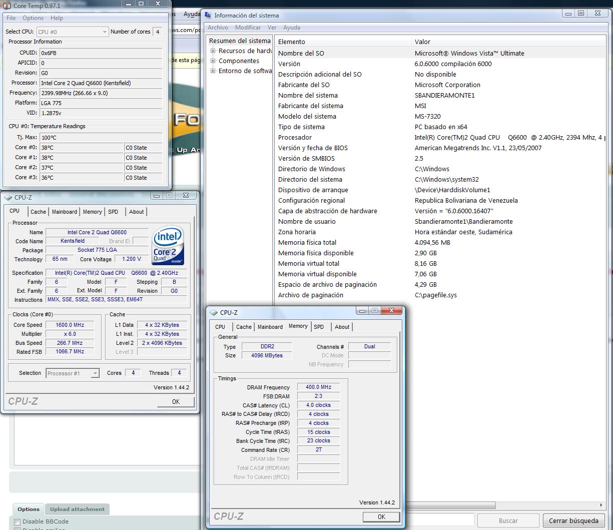

Re: And finally.... My system has arrived...
I have just tightened the RAM memories' timings to 4-4-4-15 2T 2.1V, and I have grown even more frustrated since then... The only variables that I changed from the BIOS were CAS , TRCD , TRP , TRAS and the memory voltage (2.1V).
I get more freezes now, the system freezes while window starts, when I click anywhere on the screen, sometimes I get blue crash windows and restarts, and sometimes the system resists about an hour.
To help you help me, I post this picture:
I don't know what I'm doing wrong here. I have removed from my rig one of the GPU's, the sound card and every USB, fireware and IEEE1394 cables from the motherboard just to simplify the problem. I have double checked the correct installation of the rest of the components.
And about the CPU, the picture says that VID is 1.2874v while the core voltage is ranging from 1.12V to 1.26V, depending on CPU usage. When CPU is at 0% usage the core temp tends to 1.12V while temps reach is low to an average of 35C. The opposite holds true. I thought that core voltage was supposed to remain static. Are the CPU temps high?
I will really appreciate help here, particularly with my system instability.
Thanks.
Thanks.
Changing core voltage (and clock speed) is normal as this is part of intels speedstep technology to reduce heat and power when the CPU is idling.
What is the TRC setting in the BIOS? If it is at 23 like CPUz reports, try changing it to 30.
If that doesn't work then what I need you to do is take out one of the 2GB kits of RAM, leave the settings like they are supposed to be (i.e. what they are at now) and run memtest for a couple of loops (like an hour).
If that kit passes, swap them out for the other kit and repeat the tests again with the second kit.
Basically at this point we need to know if it is actually faulty RAM, or your northbridge not being able to handle 4GB (for whatever reason), or if the issue is something else entirely.
