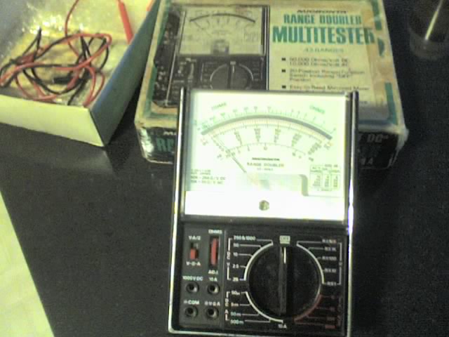

I believe you want DC V or the Top Left and the 250 & 1000V settings
DMB2000uk
Posts: 7095
Location: UK
Re: posting but not loading OS
Post by DMB2000uk »
Black wire goes in com, red wire goes in V Ohm Amp, and switch the dial to the left, erm, 50v should be where it's at.

"DC V or the Top Left and the 250 & 1000V settings"
any of the other settings need to be changed?
i'll give that a shot after i get my homework done tonight, once i get more confident in this multimeter thing

whoops I thought that said W. You need the setting below that.
stopthekilling77
Posts: 2188
Location: Colorado, USA
Post by stopthekilling77 »
dicecca112 wrote:whoops I thought that said W. You need the setting below that.
the 50v selection?

DMB2000uk wrote:Black wire goes in com, red wire goes in V Ohm Amp, and switch the dial to the left, erm, 50v should be where it's at.
Yup :P
