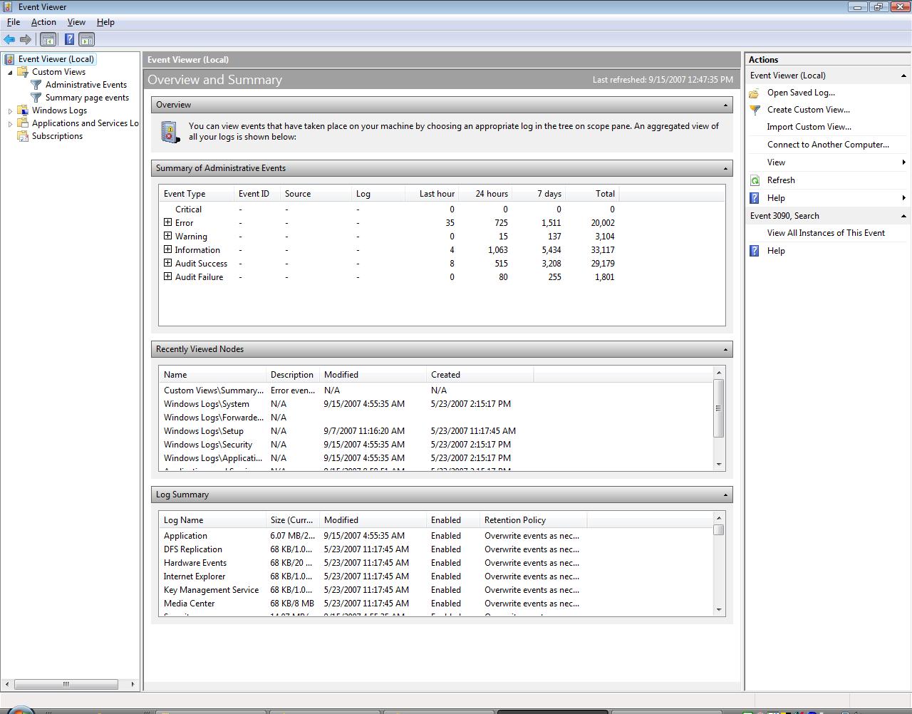

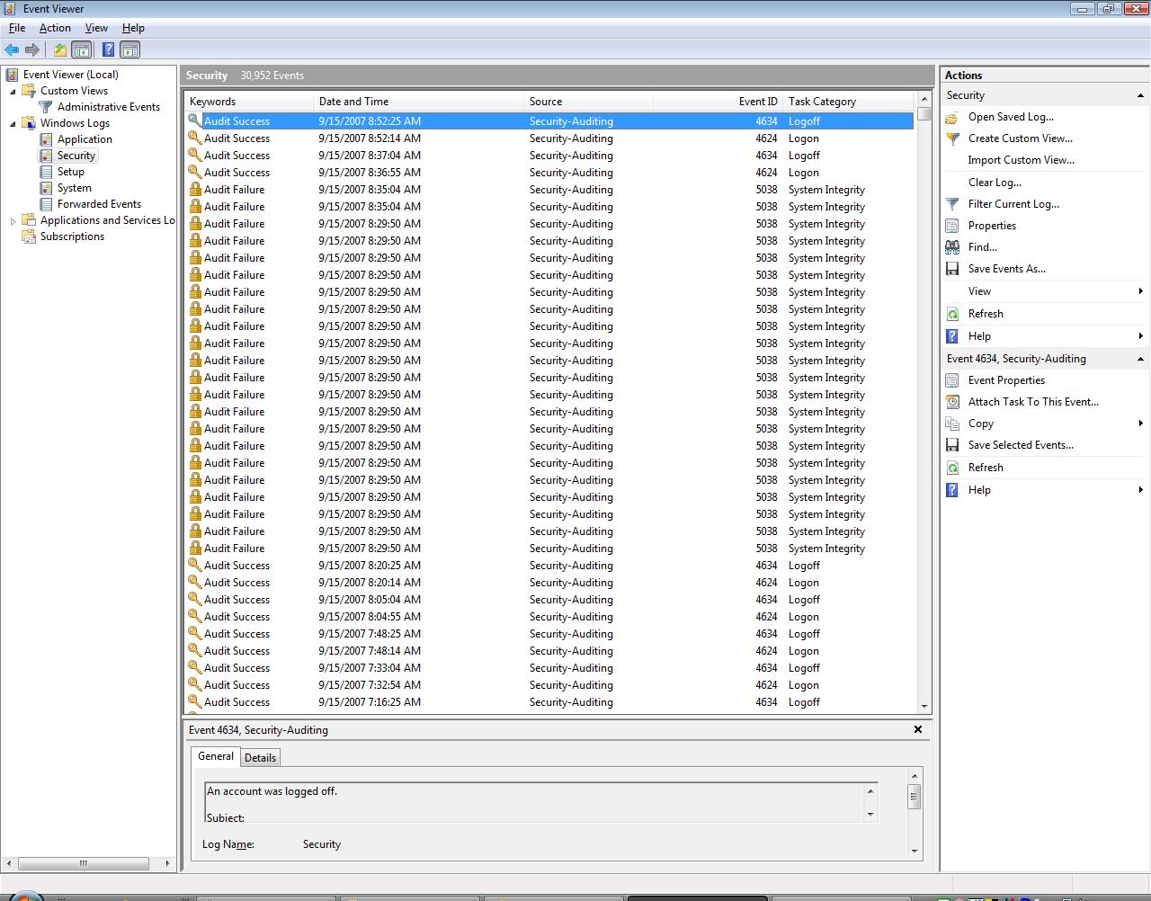

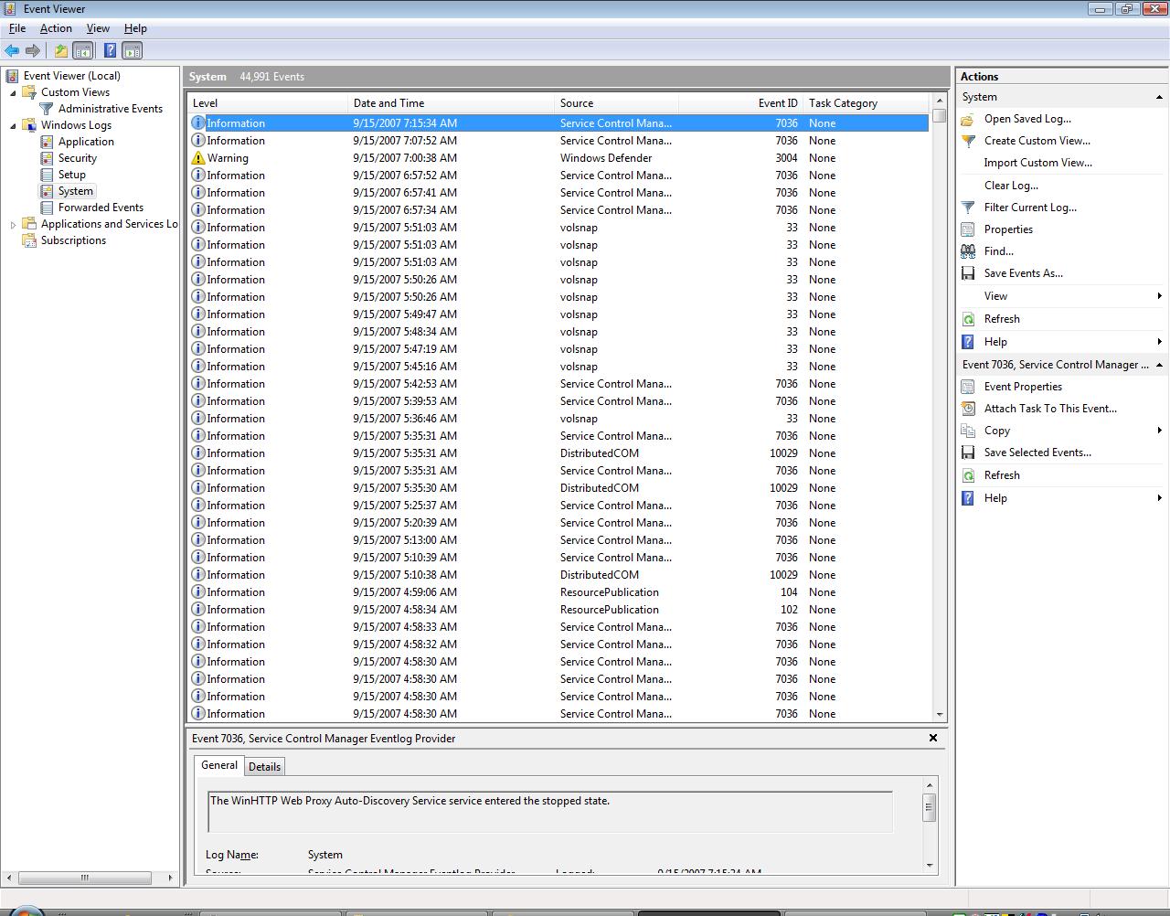

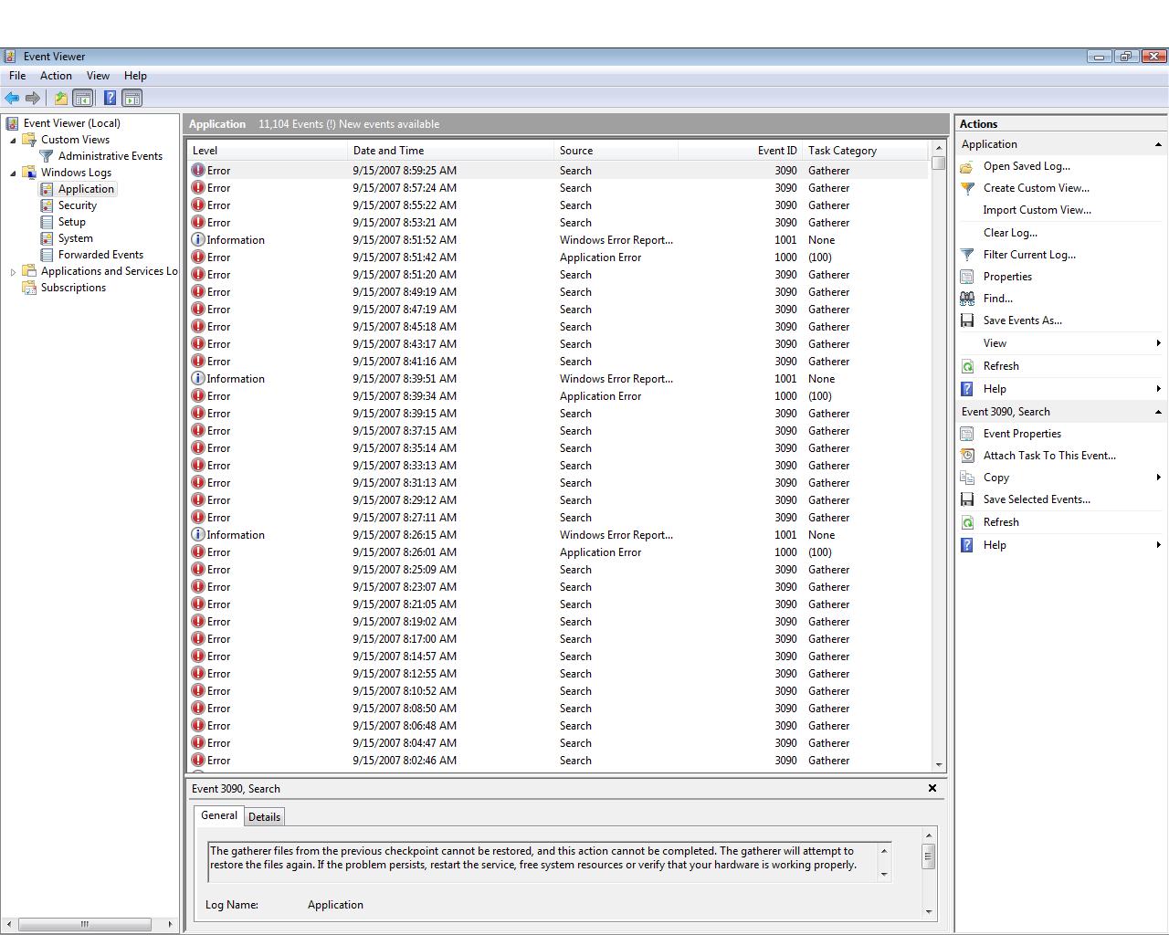

Can you post a screenshot of event viewer? (The Application and System pages) Just the top ones.
Have you tried a different PCIe slot?
Event viewer having errors doesn't nercessarily mean there's a prob either ;)

KnightRid
Posts: 4295
Location: Dallastown, PA
Re: Computer hosed - help needed
Post by KnightRid »
I can give thousands more pages if you want :)
Applicantion Log
Applicantion Log
Security Log
Security Log
System Log
System Log
Mike
Looks like jumbled words to me :rolleyes: hope it helps - told you I got TONS of errors ;)

There's nothing wrong with the event viewer logs (apart from the fact it's Vista! --> all those search errors!)

Logs look fine? WOW - IE crashes about every 5 minutes or even more often and has to be restarted! Since i unhooked the regular netowrk the computer has not rebooted much at all by itself. FAH will no longer run, but that be cause i removed the login password so the computer would just login by itself.
Mike
and all those errors!!!
Main Event Viewer Screen

That sure doesn't look normal to me, in the last 7 days I've had 11 errors on my Vista install, with uptime at a bit over 9 days currently.
