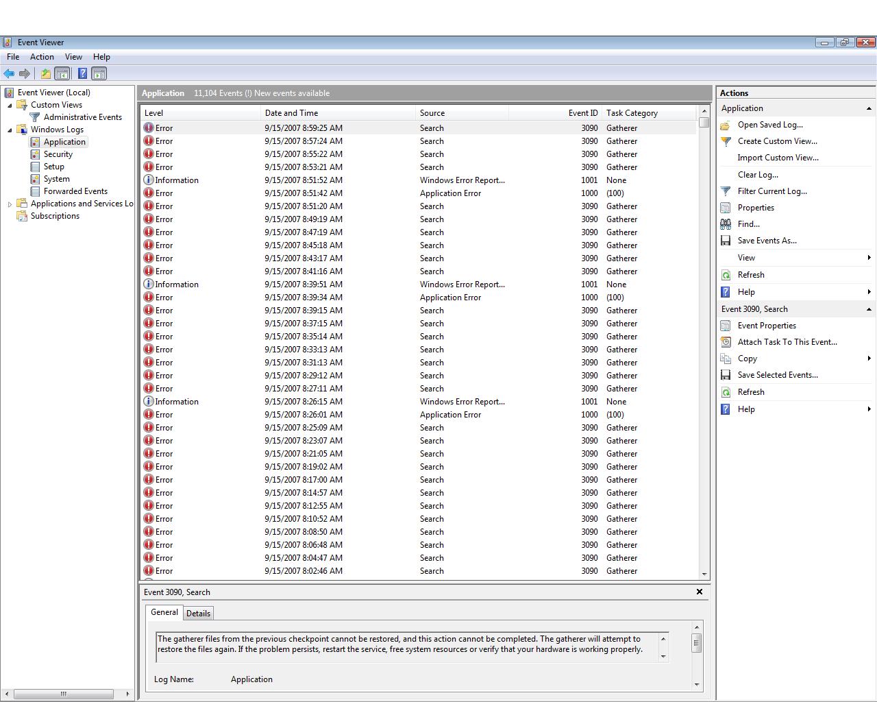

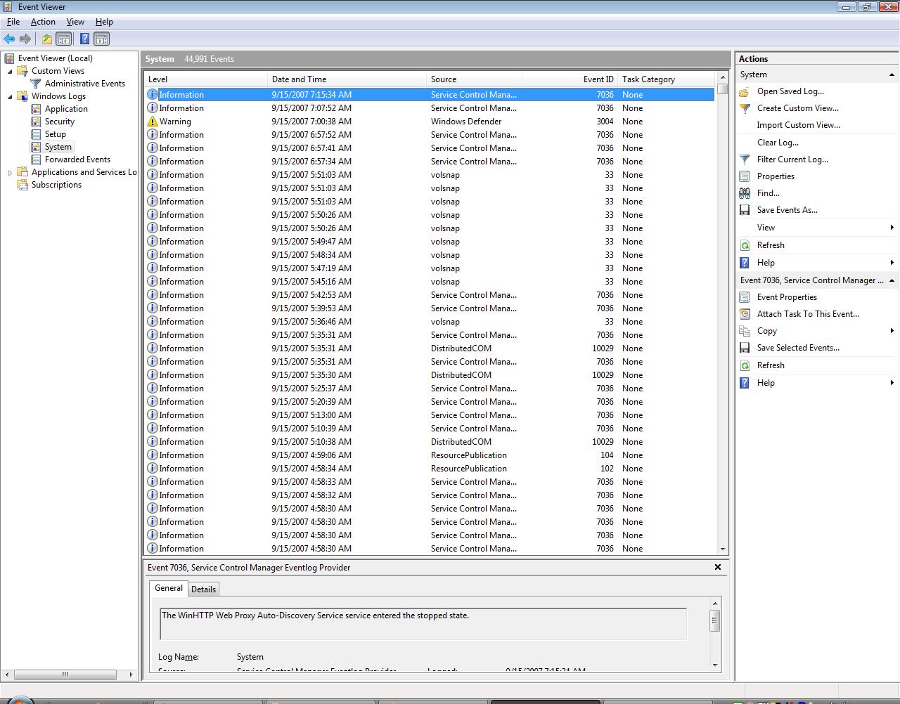

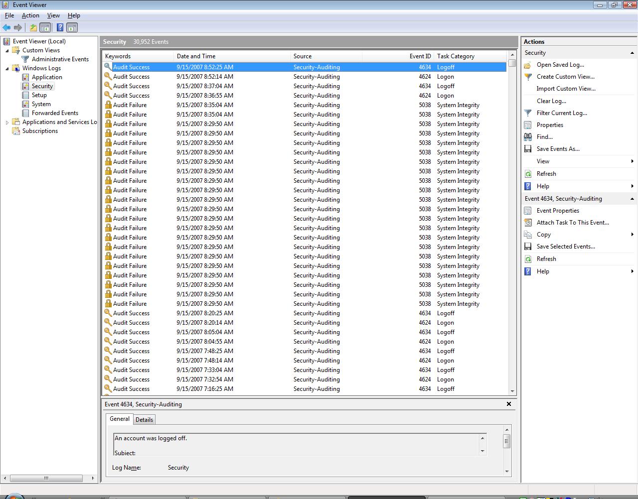

I can give thousands more pages if you want :)
Applicantion Log
Applicantion Log
Security Log
Security Log
System Log
System Log
Mike
Looks like jumbled words to me :rolleyes: hope it helps - told you I got TONS of errors ;)

Re: Computer hosed - help needed
Posted: Sat Sep 15, 2007 7:28 am
by kenc51
There's nothing wrong with the event viewer logs (apart from the fact it's Vista! --> all those search errors!)

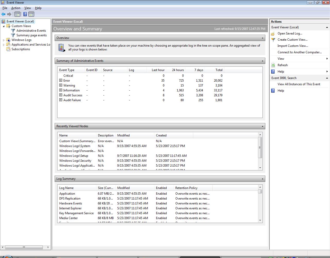

Logs look fine? WOW - IE crashes about every 5 minutes or even more often and has to be restarted! Since i unhooked the regular netowrk the computer has not rebooted much at all by itself. FAH will no longer run, but that be cause i removed the login password so the computer would just login by itself.
Mike
and all those errors!!!
Main Event Viewer Screen
Posted: Sat Sep 15, 2007 11:05 am
by Zelig
That sure doesn't look normal to me, in the last 7 days I've had 11 errors on my Vista install, with uptime at a bit over 9 days currently.
