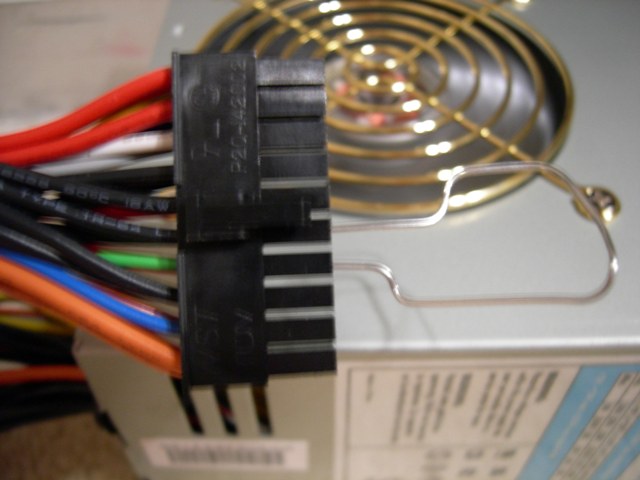

what if you unhook everything from the power supply and try to jump start it to see if it even turns on. If it does you can use a volt meter to see if the rails are still good.
If you don't know how to do this locate the Green wire on your PSU. There should only be one Green wire, whether you have a 20 or 24 pin power cable. Then take a paper clip and insert one end into the Green wire and the other end into any Black wire. Your power supply is turn on... if it doesn't then you have a dead PSU.
If you are color blind ask for help! :owned:

i'd still check the rails... first thing i always check is the PSU... I've had several bad PSU's right out of the box over the past 10 years. I guess the second thing would be remove the HSF and see if it was seated right. (look at the thermal paste to tell) if it wasn't it might have fried the board. The CPU should have shut down before getting over 80C.

ok..well ill try the clip thing...since i have no tools to read amps or anything..i do know while trying to get the screws into the heatsink it did move...although i tried to keep it from moving...the motherboard light still lights so hopefully it didnt go lol...but ill check...just was a pain in the a$$ to install that heatsink..its worth it tho to check
