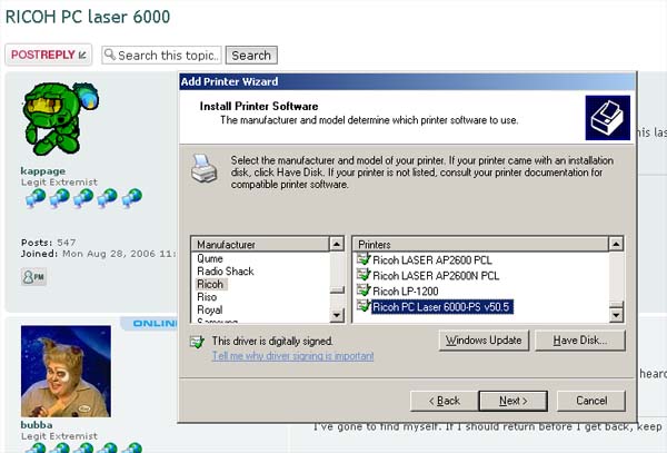

wow.. '88, yeah don't think you're going to get drivers for that. Explains why my service guy never heard of it. It was made before he was born
I went and changed my google wording a little and got M$ site and they say it is part of XP, I went through the printer wizard, low and fricken behold its there
have you tried that one.

Re: RICOH PC laser 6000
You Rock bubba, ill give it a shot later tonight, i plugged it in earlier and it seems to be working because it was able to print some test pages, all working fine, and nice a clear writing.

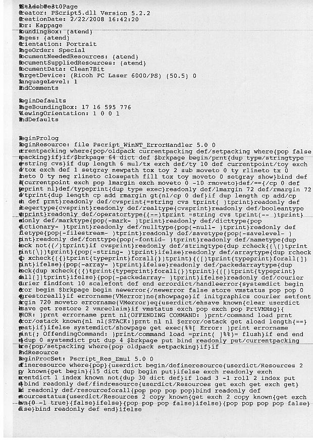

Hmpf, well i ahve plugged it in told xp what port to find the printer windows sees it says that it is ready to print but doesnt! the printer has a little screen on it and it is blank when i turn it on when it is already plugged into my pc. It also doesnt seem to be 'responding' for when i press the menu button nothing happens..
Any ideas?
After getting a NEW new cable which has a parrallel port on one end and some Funky printer port on the other i got it to print a microsoft Windows Test page but it came out like this.
My first assumptions was that my computer isnt sending it in the right format?
Looks like the wrong option is set up.
Try adding the printer again, chose the Post Script option in the setup.
Then set the printer to Post Script, Parallel interface, and try line wrap set to disabled.
See what that gets you, starting to run out of ideas on this one.
