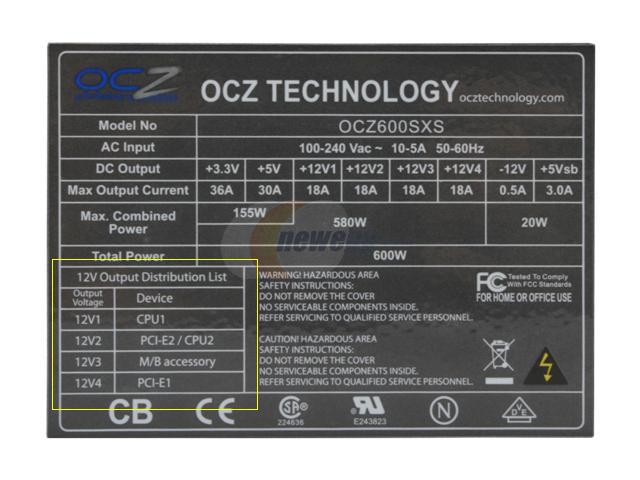

I'm not 100% educated on the specifics of how power supplies work, but I've been reading up on them recently. An important part of what makes a power supply reliable is often overlooked; the number and quality of their 12V rails. You'll notice that higher quality, more expensive power supplies often have 2-4 12V rails. As far as I know, the benefit to having more than one rail is the load distribution over more than one rail, reducing stress and wear on them. You'll notice in the picture I've attached how the four 12V rails are segregated and what components they provide power to.
Perhaps your CPU's single 12V rail is giving out and providing insufficient power to your system.
- Attachments
- 17-341-010-03.jpg (44.82 KiB) Viewed 9564 times

thats what i am starting to think. I just ordered that PS you have a picture of this morning off of newegg. for $54 its a good price, and i am sure I will need a PS anyway someday.
Re: Random Freeze ups
well the PSU wasnt the problem either..lol - - if anyone else has any possible cause I am all ears.. but i will continue to throw money at the problem till every thing has been replaced!!
