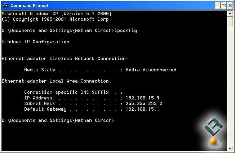

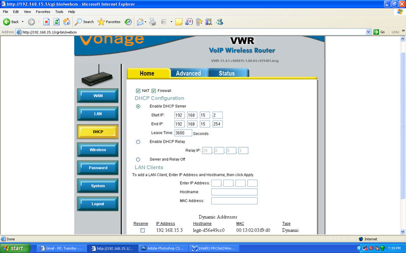

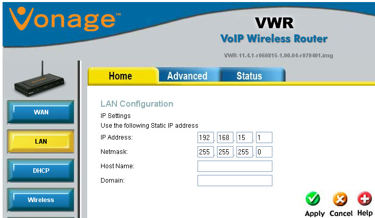

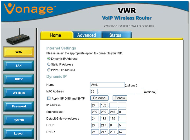

okay, so I took the switch out of the equation and this is what I did for testing...
I unplugged the Scientific Atlantic Webstar cable modem and the Vonage VWR-VD (D-Link) wireless router. I then plugged in a patch cable to the cable modem and inserted it into the internet port on the wireless router. I booted up the cable modem first and once the power and cable lights were solid I powered up the Vonage VWR-VD (D-Link) wireless router. I then went upstairs to my PC and fired it up. The PC is connected to a patch cable and is connected into port #1 on the Vonage VWR-VD (D-Link) wireless router. Cable Modem -> Wireless Router -> One PC

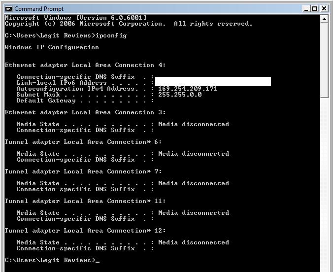

Once the PC fired up I had local connection only... I did an IPConfig and it showed this:
I tried to connect to the wireless router that I was connected to via the patch cable and no dice... 192.168.15.1 would just time out since I was on a whole other protocol.

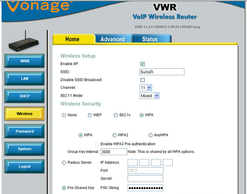

I then fired up my laptop and the wireless internet works... Here are some of the settings that are on the router.
Dynamic IP Adress is set by factory default.
The LAN Configuration is set to use the IP address 192.168.15.1
The DHCP Server is enabled and ranges from 192.168.15.2 to 192.168.15.254
The Wireless settings are set for WPA wireless security and since wireless works, nothing is wrong with that. Am I missing something here?

So it appears that DHCP is in fact turned on in the router ...
But that 169.* address is a bogus thing that windows does when it can't find a DHCP server on the LAN.

So, without internet coming into the wireless router it assigns an IP to a system on the LAN.

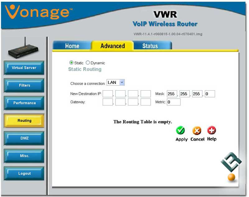

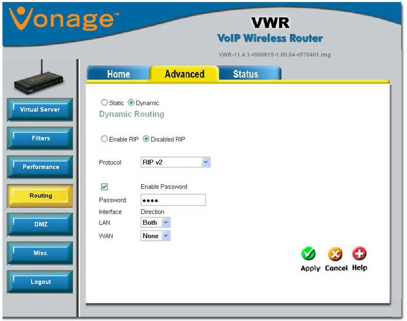

pwcmed wrote:I looked at the manual and saw in the advance tab under routing their is an option for for interfaces on the bottom if dynamic is chosen. That might help.
PWCMED,
Thanks for helping me out... I looked under Advanced and then Routing and there is a LAN and WAN drop down menu and both are set to Static as shown below.
If I enable Dynamic routing it give me this menu:
Not sure all all those settings mean and this seems a bit crazy for just setting up a home network.

Darkstar wrote:could be wrong, but what i was saying in the first post about the problem with the Ip address, if you set the router to static you need to enter the modems ip in the static table, i dont think you can have the modem acting as a dhcp server and the router also.
:drinkers:
That's the problem I had with my DSL modem. The modem and router were both trying to do "router" functions (nat, dhcp, etc) and I was unable to connect to secure sites. I ended up turning the modem into a "dumb modem" and let my linksys take care of everything at the problem was solved.
Re: Home Network Issue
Posted: Sat Nov 15, 2008 7:04 am
by Skippman
That's why I recommended turning of DHCP functionality on all but the last device in the network. I'd also recommend setting up an IP forwarder so you could access the Vonage device through the Linksys.
