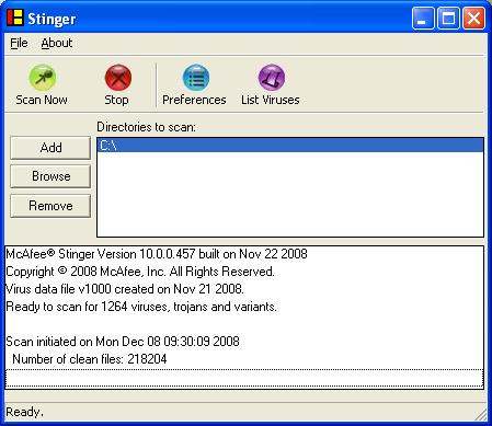

Here are some screen shots of the scans...

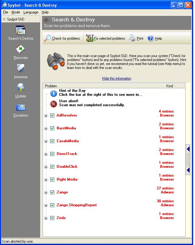

1st up Spybot:

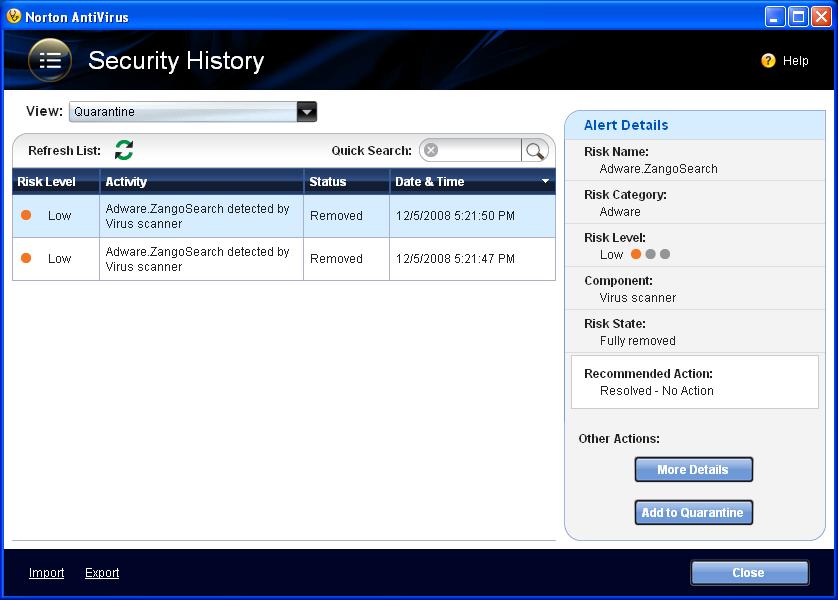

Even though Spybot said it removed Asware.zangosearch it was still detected and removed by Norton

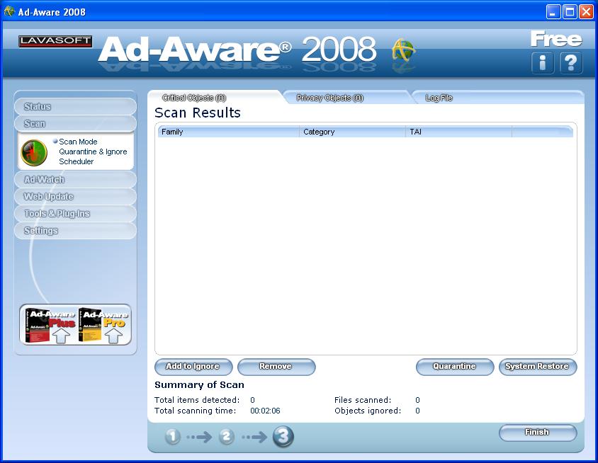

3rd up Adware, which quits at 2min 6 seconds and goes to this screen:

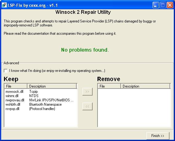

O10 - Unknown file in Winsock LSP: c:\windows\system32\nwprovau.dll
Winsock Exploit - Spyware

dicecca12 called the few i caught and a couple more...another program i keep On my USB "fixit" drive is "Stinger"
http://vil.nai.com/vil/stinger/
:drinkers:

Re: Removing Spyware and Trojans From a Dell B110 Desktop PC
I ran stinger and it found nothing:
I then tried to get rid of - O10 - Unknown file in Winsock LSP: c:\windows\system32\nwprovau.dll, which Matt said was probably Spyware. For that I download LSPFix and it came back clean...
When I boot the system I get an error saying that it can't load lisepeyo.dll and I can't figure out how to get that error to go away. I ran HijackThis again and here is the latest log file... Still lots of junk on it.

No more DLL errors when the system starts or anything... Cheers to everyone for all the suggestions! If I missed something be sure to let me know.
In order to clean this PC I ran Spybot, Adware, Stinger, CCleaner, LSPfix, Combofix, and Norton 2009 and it took 3 days of tinkering with it...
