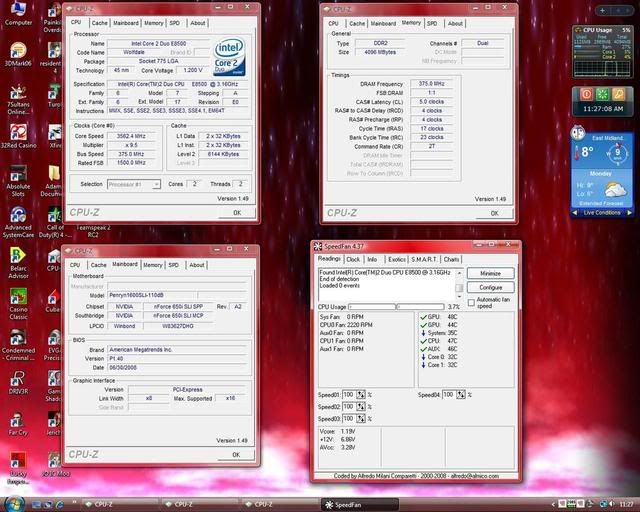

ok he is my CPU-z Information. Tell me what you think? also there is a Temperature Monitor Speedfan.

Re: Another Overclocking Issue!
I think how are we supposed to read something that small?

 you guys cant read that. wow i can read that no probs so can MR _NONAME
 you guys cant read that. wow i can read that no probs so can MR _NONAME  . anyway in your message mr_noname i have done that but it still doesnt work, voltage increased to a stupid 1.4. i dont want to go higher in case of over heating so is there anything i am doing wrong.

Sorry but I can't read it either.

Was just able to make out the 1.2000V.. but barely!

I just noticed your RAM timings, thanks Image Zoom add-on. You have your timings a little tight.
375Mhz
CAS Latency 5
RAS to CAS 4
RAS Precharge 4
Cycle Time 17
Bank Cycle Time 23
Let me preface this by saying I am no extreme tweaker/clocker. But, in my own experience having a lower value on the RAS to CAS and RAS Precharge than my CAS Latency gives undesirable results. Are you manually changing these values or do you have them set to Auto in the BIOS?
						Edit
375Mhz
CAS Latency 5
RAS to CAS 4
RAS Precharge 4
Cycle Time 17
Bank Cycle Time 23
