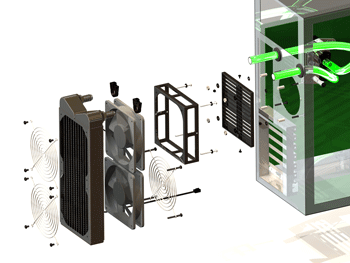

Your temp issue is due to the rad. The res top rad you have is NOT to be mounted flat like you have it.
Vertical, res to top only.
You're getting air trapped in the res in the top of the rad, then you get the bubble run through the system.

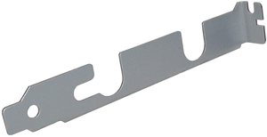

Need a rad box and hang the rad off the back like this, but res top up and fittings at bottom and run the hoses through an open expansion slot.
