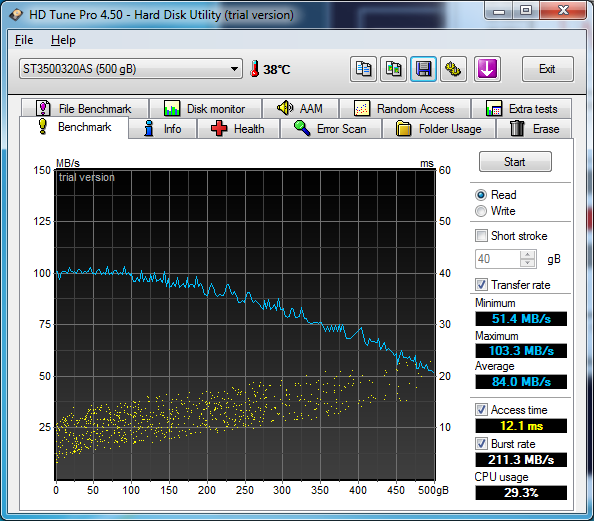

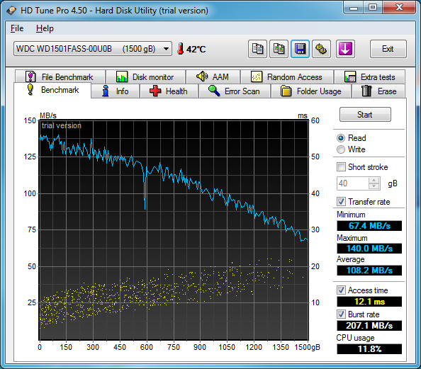

I'm having some troubles with my new HDD. I picked up a 1.5 TB WD Caviar Black from NewEgg, and it was a pain in the arse to get the BIOS to see it. Well, it's seeing it, Windows sees it, I can read and write from it. But I've noticed performance issues... I decided to run HD Tune and see what was going on.... Let me know what you think I should do. The second screenshot is my 7200.11 Seagate 500 GB HDD.

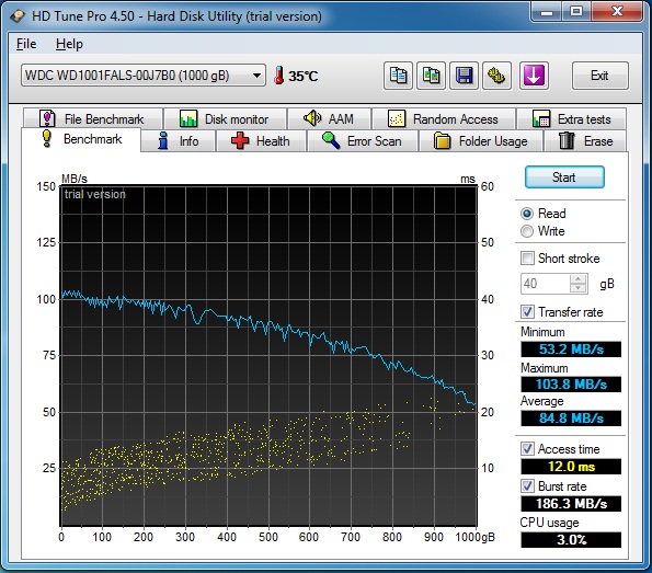

why is your cpu usage so high? (doesnt matter performance-wise i ran the test with 6cores 98% stress (folding) then again with 0% usage with no change, just curious as it seems to be above 25% each time for you (one core of four stressed? + the ~3% for the test))
just ran my empty WD Cav Black 1TB from 12/2008:
what are your writes like? ATTO?

What's the problem? Seems like it's running as it should. The drive will get slower as it gets to the outside area of the platters. HD Tune is taking the average of the speed from the inside to the outside. What issues were you having when you first installed it?

This is all on a 100% fresh install of Windows 7 Professional, which I installed on my 60GB OCZ Agility 2. I have no performance issues on any of my drives, but the WD Caviar Black. It jumps up and down so bad, and I don't feel it should. My other 3 physical drives don't and my SSD only jumps here and there, but is very constant otherwise. I've noticed that the write speeds are pretty slow, when copying from one drive to the next, plus when I went to create a folder on the drive, it took 15 seconds for it to pop up. When moving 60GB worth of data from the Seagate to the WD, it was averaging about 20 MB/s. I just tried a copy of 1.2 GB from the Seagate to the Western Digital, and it averaged about 65 MB/s that time. What is scaring me about this, is the BIOS used to lag hard when trying to see the drive. It still does pause momentarily on my 2nd SATA device, but usually bypasses it now. I have moved it from SATA 5, to 3, to 2.... all with the same problem.
I want to point out the average read is 67.8 MB/s on the Caviar, but my 3 year old Seagate is faster. The minimum shouldn't be 10.1 MB/s either.. That is my other big concern, big dips in read performance.
I couldn't get the "write" test to run. It kept telling me to delete my partition... in which there is only the 1 on that drive, and I wasn't about to remove 60GB worth of data off of it to run the test. hehe

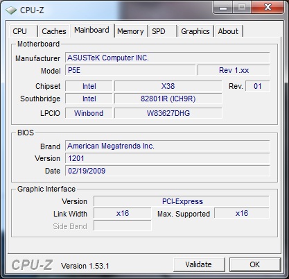

If anything this sounds like a controller issue to me. What southbridge does your computer have? Have you tried looking for updated chipset drivers?

Major_A wrote:If anything this sounds like a controller issue to me. What southbridge does your computer have? Have you tried looking for updated chipset drivers?
Here is what CPU-Z says about the chipset:
There is only one chipset driver from 9/18/09, and I'm pretty sure it's what I have installed even on my other installation of W7. :(

Ok... so I just got done reformatting, enabling AHCI and editing the registry, and installing that Intel Rapid Storage driver... and I must say, I'm much more imressed! Thank You, Thank You, Thank You!!!!!!!!!!!!!! :prayer: The tips and help were much appreciated!!!! I was going nuts seeing a brand new drive have so many problems, only to find out... it was user error! hehe
1.5 TB WD - AHCI Enabled

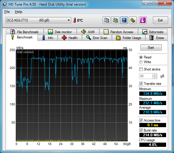

Also, for the fun of it, I ran the benchmark on my SSD. I didn't see much of a performance improvement, but the little bit was definitely welcome!
IDE Mode:
SSD - IDE Mode
SSD - IDE Mode
AHCI Mode:
SSD - AHCI Mode
