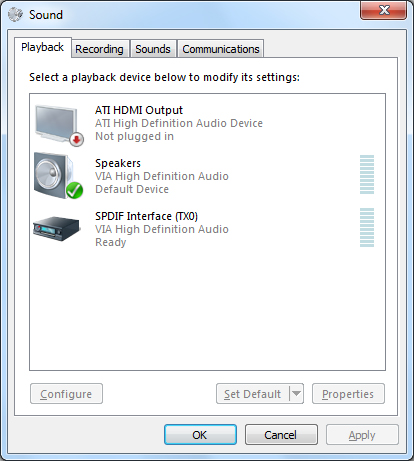

In the Sound Properties do you have the soundcard set to the HD 4850? If by default Windows is still using the original (card or onboard sound) then it might be shutting off the signal through the ATi/AMD card.
Sound properties example.
