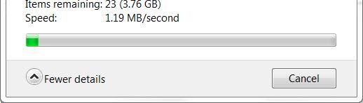

Ok, I have tried everything i found on the internet, disabling superfetch, RDC ( i think that is the letters), both of the netsh commands and nothing has increased my wired network speed much above 1mb/sec
I have a gigabit network card on this system, a gigabit router and a gigabit switch - basically everything is gigabit. Also I am running Windows 7.
I am so frustrated at this! I know on my main system I do not get much above 20-30mb/sec but that would even be a major improvement. I do not know why Windows is so hard ot get netowrking working correctly at the speeds I should be getting.
Any help will be appreciated!

Those speeds are from this computer upstairs on my laptop I am getting around 1mb/sec NOT 20-30. I would be happy with 20-30 even though it should be faster.
I may try linux later on and see if the speeds are faster. I still think there has been a bug in Windows 7 that causes this because there are WAY too many reports of the exact same thing happening to people all over the world for it to be driver issues or configuration issues.

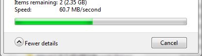

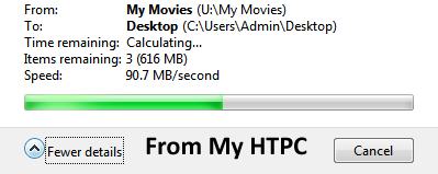

EDIT
Here is me copying the same file to and from my HTPC. I can only assume that it comes in faster because this is a beefier PC than the HTPC.

Speed I am getting from my main system Q6700 to my Core i7-920 folding computer -
So I know the main system can send fast, it seems something with the laptop is causing the problems. Both systems run Windows 7, so I dunno. I still have not tried Linux on the laptop to see if it is faster. I dont know if I can see my windows 7 shared folder inside linux or not. I will try soon.
