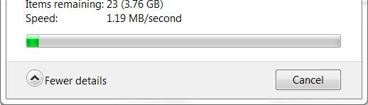

Those speeds are from this computer upstairs on my laptop I am getting around 1mb/sec NOT 20-30. I would be happy with 20-30 even though it should be faster.

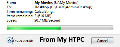

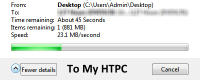

Here is me copying the same file to and from my HTPC. I can only assume that it comes in faster because this is a beefier PC than the HTPC.

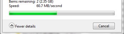

Speed I am getting from my main system Q6700 to my Core i7-920 folding computer -
So I know the main system can send fast, it seems something with the laptop is causing the problems. Both systems run Windows 7, so I dunno. I still have not tried Linux on the laptop to see if it is faster. I dont know if I can see my windows 7 shared folder inside linux or not. I will try soon.
