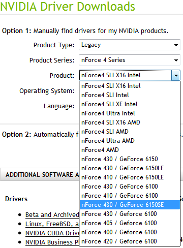

And you have the latest chipset drivers off of nVidia's site, correct? Sorry had to post a picture since I can't link to the file since I don't know what OS you're running.
Re: strange readings
Posted: Tue Feb 22, 2011 7:16 pm
by Merlin
I installed the drivers listed for the MB off of a Compaq support site. 15.49 nforce_win_vista_win7_32bit
