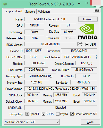

** Edit ** I see you mentioned you had GDDR5 in your first post. Do you have the 96 CUDA Core card or the 384 CUDA Core version of the GeForce GT 730 GDDR5? If it's the 96 core version I'd return it in a second. I believe the older 96 Core cards are using the GF108 'Fermi' GPU and the newer 384 Core cards are using the newer GK208 'Kepler' GPU.
If you open GPU-Z look at the core count that should tell you what you have.

OK. Looks like I have the later version although I was unable to find a specific field that shows number of cores.
Prior to running GPU-Z, I ran DDU then installed only the nVidia display driver (v 362.00). Less than 10 minutes later, as I was reading your response, I experienced another crash. This time it didn't recover. I decided to wait to see what would happen and, after a couple of minutes, my PC restarted on its own.
