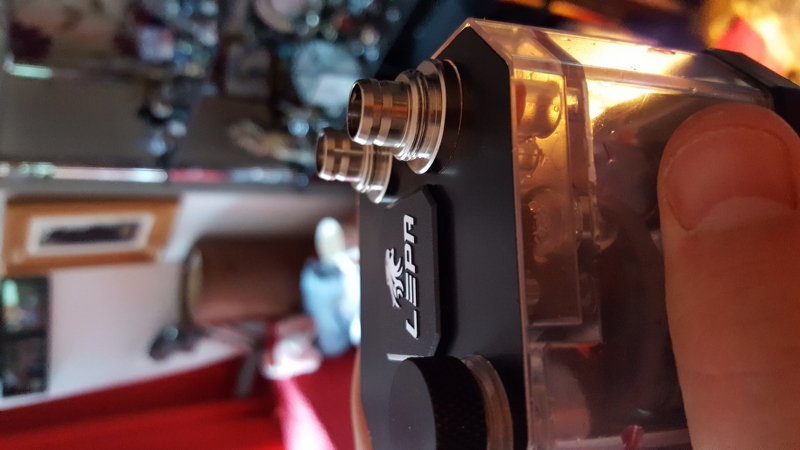

This is a picture of my fittings. As you can see it's barbed but has a threaded bottom. I am looking for a right angle or even a 60 degree fitting to screw on to the thread with a barbed end. If not a barbed end something that I can screw a barbed fitting into :)

ok so after a lot of messaging around I found the measurements of the pump/res and the threaded part is g1/4" and 16mm or 5/8" diameter and the barbed top is 10mm or 3/8" diameter. I need a 90 degree fitting that will screw over that and be at least 25mm tall with a screw cap barbed ending. Is it possible to find an adapter that can screw over the current non-movable fitting that has a barbed end at 90 degrees?

I've found a double ended 90 degree barbed compression fitting at last. So what i'm going to do is connect a 3cm piece of tube to the standard fitting on the pump as in pic in previous message, then attach the 90 degree fitting to the other end and finally a 40cm piece of tube to the rad and thus complete the system.
It's an awkward way around what in theory is a simple job but I believe I can get this to work even with only 12cm clearance of which 8cm in the res/pump alone :finga:
