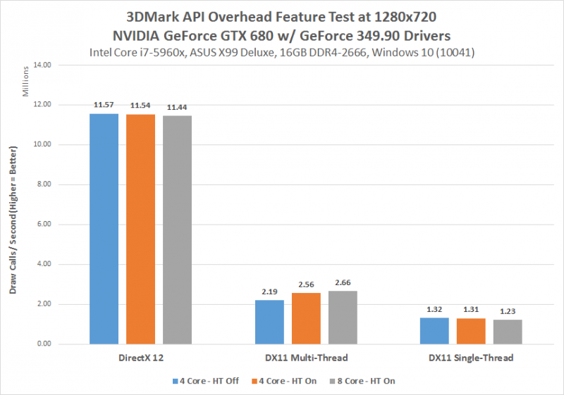

Sorry for the delayed response... Had some major family emergencies this week and was just able to get around to testing this for you today. Here are a few quick runs on a GeForce GTX 680 (couldn't find my 660 quickly in storage, so I figured this would suffice). I ran it on 4-core and 8-core with HT enabled so you can get an idea of quad-core performance on your system. The results don't exactly make sense, but these are the average of three runs at each test (so 9 total benchmark runs of the API test).KnightRid wrote:I would love to see some numbers on older cards since I have read that cards from the 400 series (nvidia) to the present will be able to take advantage of DX12. I am guessing there wont be a huge increase in performance because the cards were not built to optimize for DX12 but if there is enough of a performance leap, people with older cards may benefit greatly.
