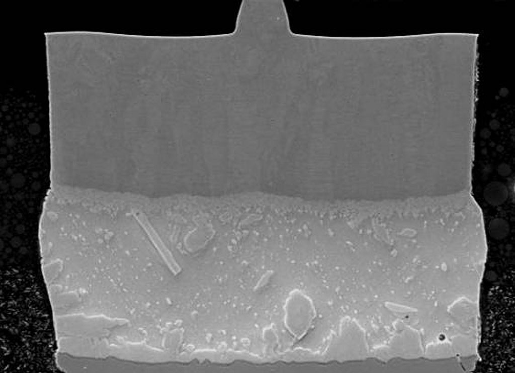

Lead free solder is much less reliable than Tin-Lead solder. Studies has been done in the past 20 years to find an alloy that has similar visco-elastic properties as eutectic Tin-Lead alloy. There is none. In fact, from the cross-section of Intel's lead-free solder bump, it shows that Intel intentionally increased the copper bump thickness (UBM layer) so they can use less Lead free solder.
I personally have dealt with a lot of cell phone designs that went to ROHS and lead free a couple years back. Mechanical shock and vibration testing have shown that lead free solder is not up par (not equivalent to) tin-lead solder but the cost of using lead-free solder is much higher due to the control of Ag content in the alloy. The board design of lead free parts had to deviate from IPC recommendation to improve the shock and vibe performance.
Another critical issue about lead free solder is Sn leeching. I guess this is another reason why Intel went into a thick copper bump. The lead free solder is high Sn which went biased in current will create a brittle inter metallic compound at the interface. I do not know of any rigorous life studies of this phenomenon; unless Intel has their own data (I assume they do). But if Intel has their own data in this area and decide not to share with IEEE, then I also assume it is a negative.

The cross-section of the lead free bump shown in the article already shows some Sn intermetallic growth on the copper pad.

So true! Great first post and thanks for joining to share your thoughts. You said the cross-section of the lead free bump shown in the article already shows some Sn inter-metallic growth on the copper pad. Is that what the slightly darker layer is on both top and the bottom? Here is a higher resolution picture of a lead-free bump for you to look at. I'd be interested in knowing if that is tin, why it is doing it.
high-k metal gate processors with a copper column “bump” and a tin/silver/copper solder alloy shown here

Yes, the thin halo between the copper and the solder should be SnCu intermetallic which is very brittle.
It shows this construction is less reliable.
In the leadframe type packages (very old technology), where pure Sn is plated on top of pure Cu, the thickness of the SnCu intermetallic is controlled by using an annealing process to create SnCu3 intermetallic which is stable when current passes. Otherwise, SnCu6 is formed when current passes through the copper-Sn interface and over time it will consume the interconnect. None-the-less, any SnCu intermetallic is brittle in the scale of a flip chip interconnect.
