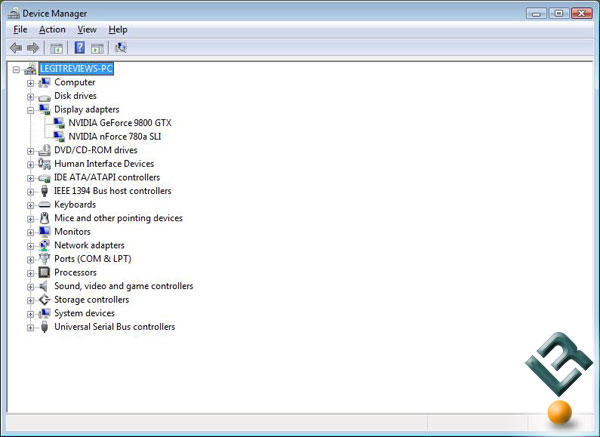

Here is Windows Vista Device Manager with the nForce 780a SLI and GeForce 9800 GTX in Performance Boost Mode.
Windows Vista Device Manager with Hybrid SLI in Performance Mode
Note both the IGP and Discrete Graphics are seen.

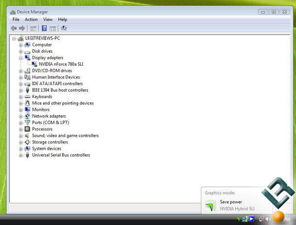

Windows Vista Device Manager with Hybrid SLI in Power Save mode.
When I switch profiles to the Power Save setting the other GPU drops completely from the system. It really does have all the power cut to it as the image above shows. If you click it to make it larger you can see the Windows task bar at the bottom showing that Hybrid SLI is enabled and the system is in Power Save Mode. Very slick stuff.

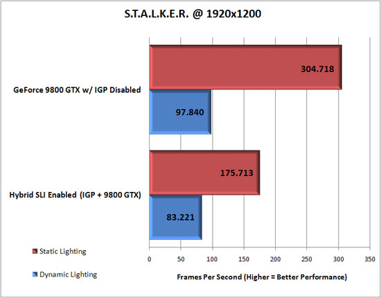

Update on 5-7-2008 at 4PM CST: Legit Reviews was contacted by NVIDIA and asked to test S.T.A.L.K.E.R. at a higher resolution. NVIDIA thought that as the resolution increases, the performance difference between dGPU and mGPU in STALKER should reduce dramatically.
When we increased the resolution to 1920x1200 (the highest supported by Hybrid SLI) the difference performance took a ~42% nose dive with Static Lighting enabled. Just for fun we increased the graphics quality and changed over to Dynamic Lighting where the system took only a 14% performance hit. After playing around with the system for a couple hours it was determined that it could be a driver issue. NVIDIA has been contacted about this and has opened a bug ticket to take a closer look.

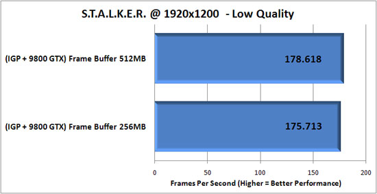

On another note a few readers have asked what would increasing the frame buffer from 256MB to 512MB do in terms of performance since the GeForce 9800 GTX has 512MB of memory on-board.
It seems that 256MB is the sweet spot, but for the boards that have a 512MB fame buffer option it should help performance slightly. We saw a 1.7% performance improvement by doubling the frame buffer. On systems containing 2GB or less this might be better used for system memory rather than frame buffer.
