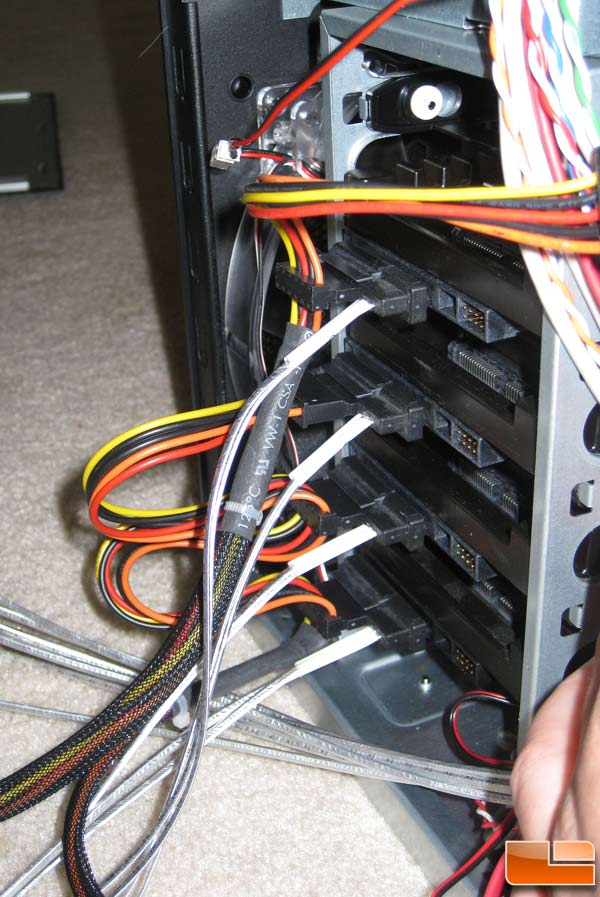

I got my hands on the HAF 922 today and was building a system in it and ran into a few problems that Shane didn't bring up in the review as I am building a 2P workstation setup with an adaptec hardware SATA Raid card on four Western Digital VelociRaptor hard drives.
I put all the drives in the sideway mounted hard drive cages and once you put on the SATA RAID cables and then plug in the SATA power headers the side door won't fit on. This is a problem with any hard drive and RAID card, so if you want to run hardware RAID the HAF 922 isn't the case for you.

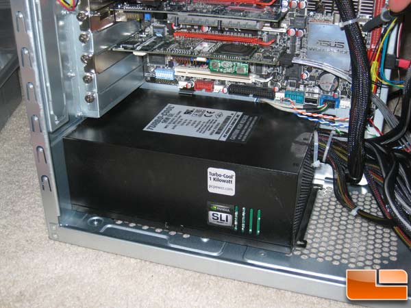

The cooler master HAF 922 fits full size power supplies, but it is a tight fight as you can see from the PC Power & Cooling 1KW Power Supply installed into the HAF 922 in the image above. The front of the PSU can't be bolted down, but that is only really needed when top mounting this heavy power supply.

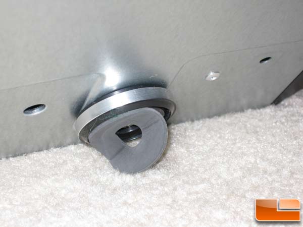

The last thing I noticed is that the rubber feet came off not once, but four times when building the system on carpet... I've never had one case lose its rubber pads the first day in over a decade of building computers, so this was interesting. They need some better adhesive on those pads if you ask me as they easily peel off if you try.

hmmmm, I slid the case around on the desk alot... guess I need to add carpet to the list :-k
That is one big f'n PSU :shock:
For the RAID, why the funky adapter for the power?

Because on many of the raid cards you have to use them ;)
