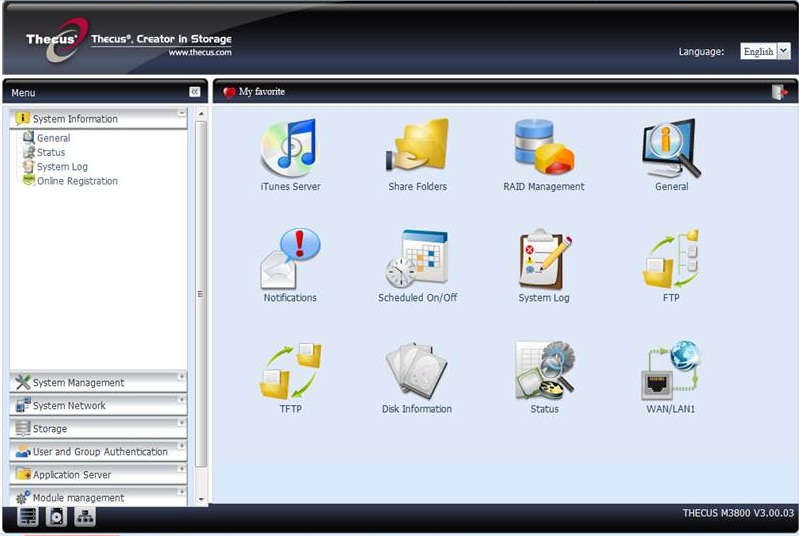

Re: Thecus M3800 NAS Stream Box - Total Media Storage
When we first tested this unit in 2009 it was done using Firmware v 1.00.02 that was released in 2008.
It was pretty plain and boring looking:
In order to update to the latest firmware you need to do sort of an incremental firmware update. You first need to apply N3200PRO beta firmware v1.00.07.1 from here - http://www.thecus.com/Downloads/beta/
This sounds odd, but the release notes clearly states that Ithe N3200Pro firmware also applys to M3800. Once you download and install firmware v1.00.07.1 you can update to firmware v3.00.03, which is valid for both the Thecus N3200PRO / M3800. You can download v3.00.03 from here - http://www.thecus.com/product.php?PROD_ID=13 or the direct download link - http://www.thecus.com/Downloads/FW/M380 ... ld2492.rom
As you can see from the screen shot below... The firmware drastically changes the look at feel of the M3800. It is great to see a company updating and releasing firmware for a product that was first released in 2008! Kudus to Thecus!
