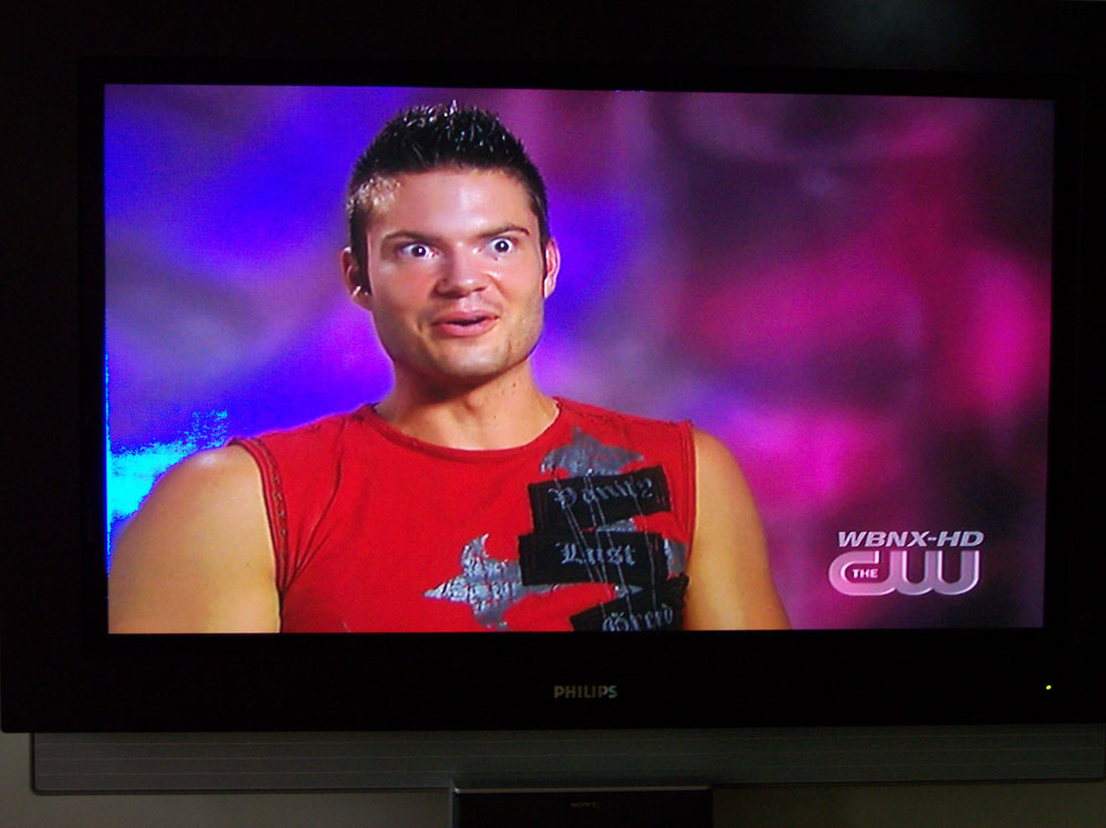

I also have a Philips 42" Plasma and I am experiencing the same problem. The TV is about 20 months old...just starting happening the last 4 or 5 months or so. The TV usually has to be on for at least 30 minutes before it starts showing up. it only appears when certain colors are displayed on the screen, meaning it's not always there. I'm hoping it can be something I can fix on my own rather than pay hundreds of dollars to some tv technician that will fix it easily in minutes!

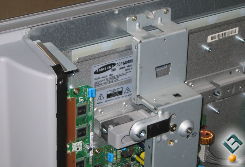

I just wanted to give everyone an update on the Blue Dots problem... I found out that since I bought the TV on my MasterCard that they will double the warranty from one year to two years and told me to get an estimate as they will pay for up to the cost of the TV for the repairs, but no more. I found a local television repair guy that would come out to my house and he charged me $100 to come out for an in-house estimate. He shows up says yup I see the dots and pulls off the back panel. He then turns the unit back on and checks all the voltages and all are good he says. There is a sticker on the upper right hand side of the back panel that tell you what the VE, Vset and VS settings should be. So he used a voltmeter to take the various voltages off the label on the inside of the computer... No brainer so far... When looking inside the Philips TV I started seeing Samsung labels every where, so all the PCB boards and the plasma panel itself are all Samsung:
I usually think that Samsung makes pretty good panels, so no worries so far... About 30-45 minutes later the blue dots don't appear again, but the internal components aren't getting as hot as the back panel is installed. He then calls a Philips service support hotline and gives them a numeric password. He then gives them my model number and tells them it has blue dots. I hear him say that he checked the voltages and confirmed the voltages with them. He then said that isn't what the inside of the TV shows... It turns out Philips/Samsung has lowered the voltages on the Television in a service bulletin.

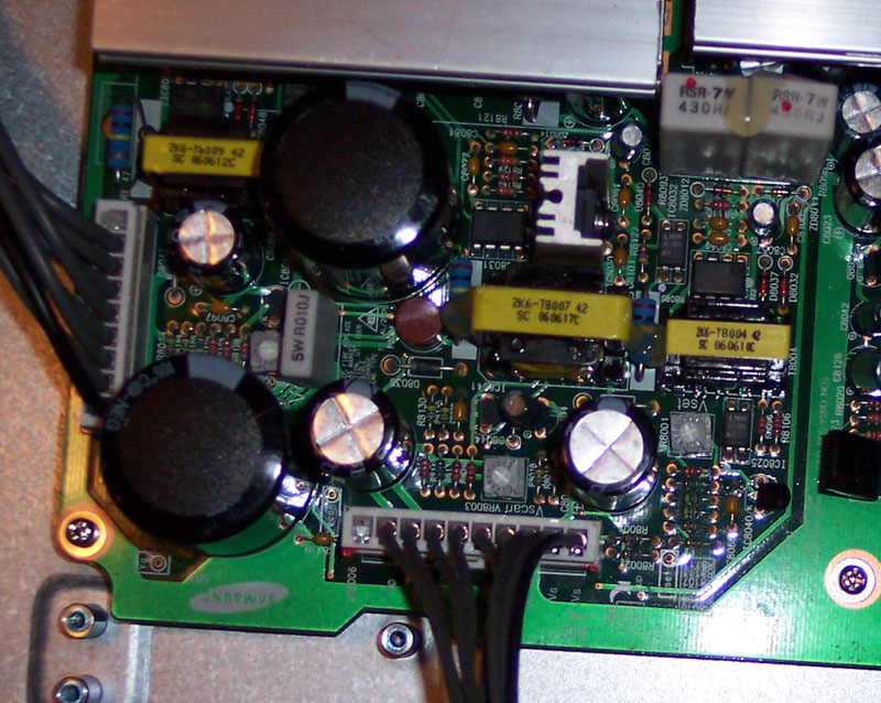

I'm a bit of a novice so I appreciate everyone's help. I have a voltmeter, which terminals am I pointing to and how exactly do I do it? Here is a photob below. I see the white screws to adjust each, just having difficult reading voltage. Also, what settings should my voltmeter be on, AC 200V?
martini161
Mr Awesome
Mr Awesome
Posts: 3183
Re: Philips 42" Plasma TV Problems - Blue Dots Randomly Appear
Post by martini161 »
is it possible to get a higher resolution photo? and what are the availible settings on your voltemeter?
