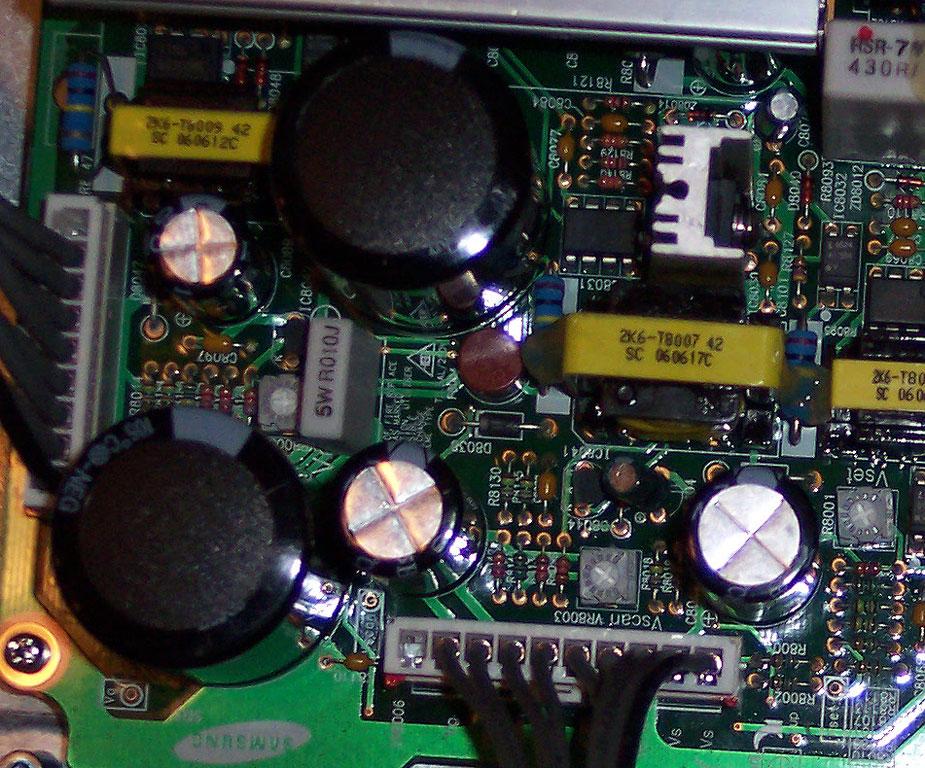

Available settings on the volt meter are:
ACV (200V or 500V)
DCV (2V, 20V, 200V, 500V)
OHM (2M, 200K, 20K, 2K, 200)
DCA (2mA, 20mA, 200mA)
and a little symbol that looks like sideways triangle with a line through it horizontally and another perpendicular line coming through the tip of the triangle

jklillibridge
- Legit User
- Posts: 11
- Joined: Tue Jun 24, 2008 2:06 pm
Re: Philips 42" Plasma TV Problems - Blue Dots Randomly Appear
Bigger photo
Bigger photo

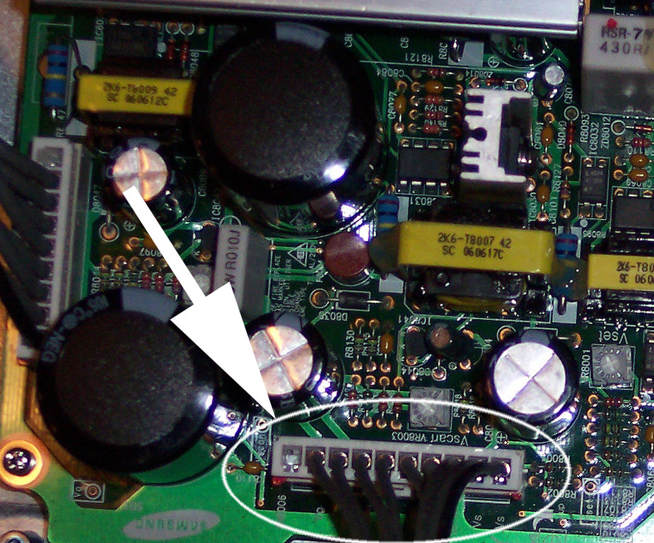

Stupid question, but what are the "pots"? I'm guessing they are the white screws that I will turn to adjust the voltage.
Also, I have added another photo below and circled the area where I first tried to test the voltage..where all the wires come in to the slots labeled for vscan,etc. I stuck my voltage meter pins down in the correct slot until I thought they were touching copper and I got nothing, so I'm assuming that might not be the place.
Is that where I am testing the voltage? Do I need to remove anything to test the voltage?

Pot is short for potentiometer (in this case anyway
). If you're not sure what a pot is you may want to rethink doing this work yourself. If you do decide to continue neither I nor anyone else on this forum will claim any responsibility if you mess something up.
Having said that, as far as where to test you want to find a spot that is directly connected to each lead on the pots. For example, on the one pot I can kinda trace the leads from:

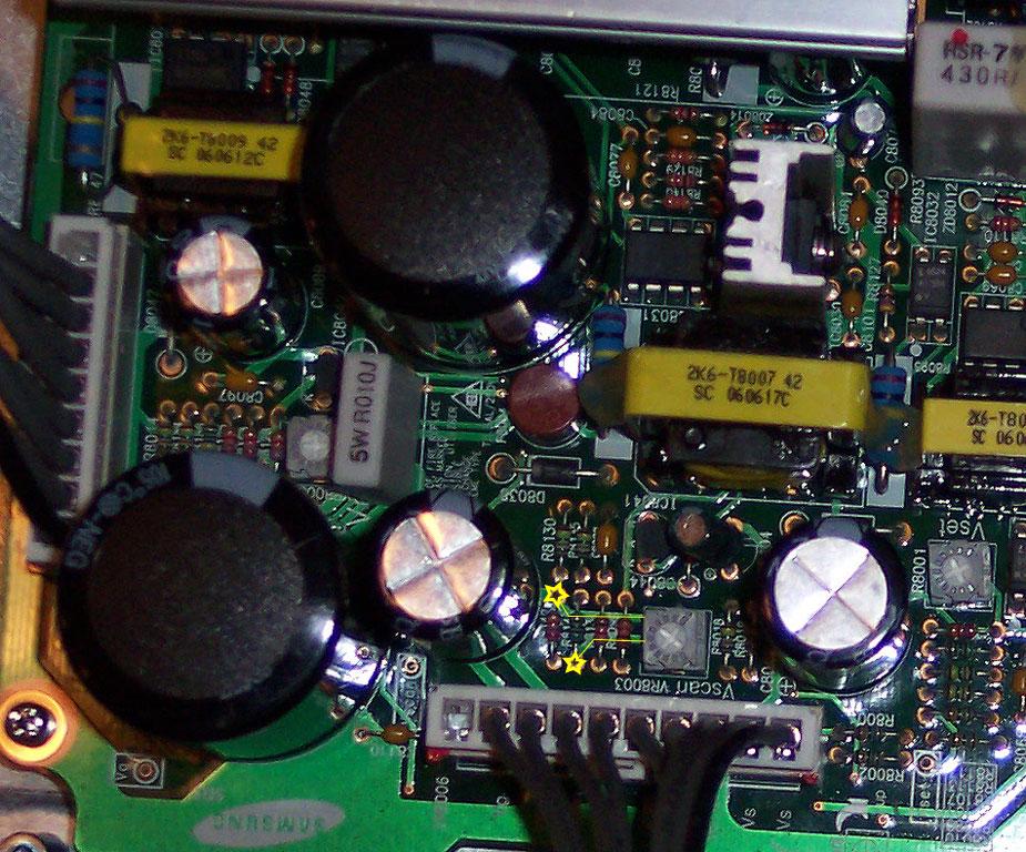

I guess I am a little frightened I will short it out, which is why I want to know exactly where to place the black and red leads from the voltmeter on the board. The diagram above with the stars is a good indicator, but looking for real specific, dummy-proof instructions.
Do I basically put my red lead from my voltmeter where Alathald drew the star on the photo and then put my black lead on a ground screw?
If anyone can help guide a rookie here, that would be appreciated...and I won't hold you responsible! Promise!

I just took a second look at the pic and it appears that there are some test points on the board...I've starred the Vscan, Vset and Vg points. You'll probably need to find a test point labeled "Ground" or "Gnd" and measure the voltage between the Voltage (Vsomething) test points and the Ground test point.

Great...thanks! I think I'm good now. I remember seeing those labels with mini holes in the board and wondered if those were test points. I'll look for the ground test point tonight as well and give this a shot.
One last, really stupid question. TV should have power, but should the tv itself be powered on? That is how I was doing it last night - power connected and tv turned on, but was not sure. I read some other thread about it somewhere else and it seemed like this guy was told to have power connected, but not have the tv on.

Well unless that circuit board has full power when the TV is on standby (which seems unlikely), then the TV will need to be on completely like it was the last time you tested.

Bump for edit on my last post, just wanted to be sure you used the correct test points. Glad we could help and if you can't find a Ground then you can probably use one of the screws or a wire that connects the board to the physical metal shell of the TV if and only if the whole TV is metal. Often manufacturers ground to the case so that it acts as a Faraday Cage and helps prevent interference. But it's probably best to find the proper test points and as Apoptosis said, if you're too uncomfortable with anything then don't risk it.

Success! I was able to test all the voltages tonight. I had my voltmeter set to DC 200V for anyone that is wondering (AC will not work).
I lowered all the voltages to the levels you listed earlier in this thread. Picture still looks good and no blue dots. TV is happily hanging on the wall again.
Problem solved. Thanks to everyone who helped out here. You guys rock.
