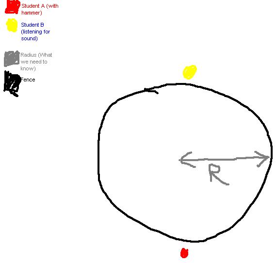

This is how i see it and im pretty sure my diagram is right.

its been too long since i did stuff like this, so i cant help you with the equation. what i can help you with is that diagram! you know there is an ellipses tool in paint right?

This should be enough for you to work through it:
Known:
V1 = 330 ms^-1
V2 = 1310 ms^-1
t2 - t1 = 0.3 s
Then, given that the circumference of a circle is C = 2*pi*r, you can rearrange to find that the distance around half a circle is pi/2 times the diameter of the circle.
So you can divide V2 by pi/2 to get the a "relative" velocity as if it was moving in a straight line across the circle.
This gives you:
d = 330 * t2
d = (2620/pi) * t1
t2 - t1 = 0.3 s
Here you've got 3 equations and 3 variables, you shouldn't have a hard time solving for d (which is the diameter, don't forget to divide by 2 for the final answer) and plugging the numbers back in to verify they work.

Zelig seems to have hit the nail on the head, I've done it slightly differently (check but verify) hope Zelig doesn't mind.
First, we need the distance traveled by the sound waves and because the air wave is a straight line the distance will be 2r, For the metal wave the distance is half the circumference C/2=2πr/2=πr
Now to find the time it takes each sound to reach the second student, we divide the distance by the velocity (remember D=V*T so T=D/V) so it takes t1=2r/330 s for the sound to travel through the air and t2=πr/1310 s for it to travel through water.
Now that we know both times, and we know the difference between the times, we can setup a simple equation: t1-t2=.30 s
Substitute the equations for t1 and t2 and solve for r! Easy peesy lemon cheesy! :)
