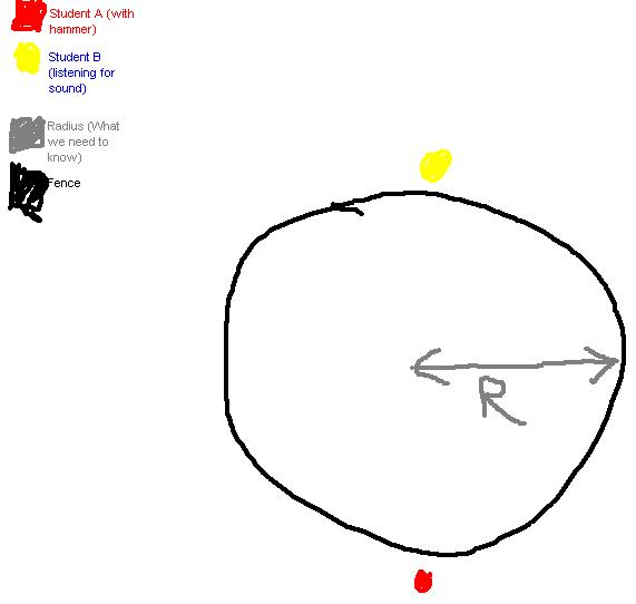

I can guarantee the answer is 82m and that the values are listed Correctly.. Heres a scanned image, i tried a few times but the paper is slightly glossy so it didn't scan too well..
My teacher said it is one of the harder sound questions in the set ive managed to do everything else fine but this one has got me stumped....
oh yea did u go by the fact that the 'm' stands for Meters??
This is how i see it and im pretty sure my diagram is right.
Any help is almost always Helpful, its probably some little thing im not taking into account or noticing.. Thanks for your help so far!

its been too long since i did stuff like this, so i cant help you with the equation. what i can help you with is that diagram! you know there is an ellipses tool in paint right?

Oops, yeah, was thinking diameter, the answer is in fact 82.
This should be enough for you to work through it:
Known:
V1 = 330 ms^-1
V2 = 1310 ms^-1
t2 - t1 = 0.3 s
Then, given that the circumference of a circle is C = 2*pi*r, you can rearrange to find that the distance around half a circle is pi/2 times the diameter of the circle.
So you can divide V2 by pi/2 to get the a "relative" velocity as if it was moving in a straight line across the circle.
This gives you:
d = 330 * t2
d = (2620/pi) * t1
t2 - t1 = 0.3 s
Here you've got 3 equations and 3 variables, you shouldn't have a hard time solving for d (which is the diameter, don't forget to divide by 2 for the final answer) and plugging the numbers back in to verify they work.
Re: HELP QUICK PHYSICS next 13 hours needed done by
Posted: Mon Feb 11, 2008 11:37 am
by Alathald
Zelig seems to have hit the nail on the head, I've done it slightly differently (check but verify) hope Zelig doesn't mind.
First, we need the distance traveled by the sound waves and because the air wave is a straight line the distance will be 2r, For the metal wave the distance is half the circumference C/2=2πr/2=πr
Now to find the time it takes each sound to reach the second student, we divide the distance by the velocity (remember D=V*T so T=D/V) so it takes t1=2r/330 s for the sound to travel through the air and t2=πr/1310 s for it to travel through water.
Now that we know both times, and we know the difference between the times, we can setup a simple equation: t1-t2=.30 s
Substitute the equations for t1 and t2 and solve for r! Easy peesy lemon cheesy! :)

Thank you VERY VERY much i went through the working on both this morning and i got about 81.98 for both so That is a big IOU need a favour just ask 8)
