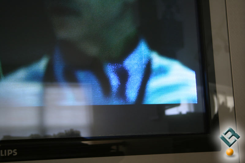

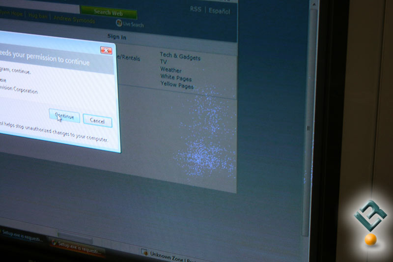

My 42" Philips TV is 14 months old and seems to be going out already. It has blue dots and streaking when used on both HDMI and Component inputs, so it's a screen issue and not the input device. Here are a couple pictures... Can anyone help me figure out what this is and how I might be able to fix it without sending it in?
HTPC via HDMI - Random Blue Dots
HD DVD -  Same Issues

The "snowy" static fix is intersting and i'm keeping my fingers crossed that this works, but I doubt it as the first 12 months I owned this TV it was fine and only in months 13-15 did it start doing the 'snow' as you can see. They are not stuck pixels because they move with the colors on the screen as you can tell in the second image...

well I don't have stuck pixels... they move around when the picture moves...
