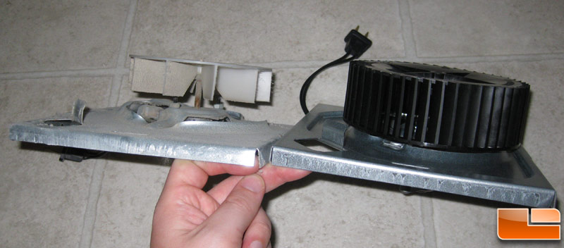

My girlfriend said the bathroom fan isn't getting the hot air out fast enough, so I went looking for a new solution today... They have high cfm fans that cost $80-$120, but they require cutting drywall and all that stuff... I wanted the lazy man solution and ran across the NuTone 690NT White Exhaust Fan Upgrade Kit...
I have a Broan N688 that the builder installed when the house was built back in 2005. This is about as cheap as bathroom fans come and costs just $14 online and at Lowes. This fan is just a 10" x 10" box that has a fan that is capable of moving 50CFM of air and has a rated noise level of 4.0 Sones... Not too much air flow and is only designed for bathrooms up to 45 SQFT. My bathroom is bigger than this, so good to know my builder used the right stuff in my house. Here is a great website that helps you figure out the math for what size fan to use for your bathroom.
I headed up to Home Depot and while it wasn't on display they had a box on the shelf for the NuTone 690NT White Exhaust Fan Upgrade Kit... It basically is a new fan and motor that works with NuTone models 693, 695, 696N; Broan models 670, 671, 688, 689; Nautilus models N671, N688... Score one for the home team as it works with my model and costs $28 at Home Depot or $34.64 online. It is rated at 60 CFM and 3.0 Sones, so 20% more airflow and 1.0 Sones quieter. At 60 CFM this is good for bathrooms up to 50 SQFT.

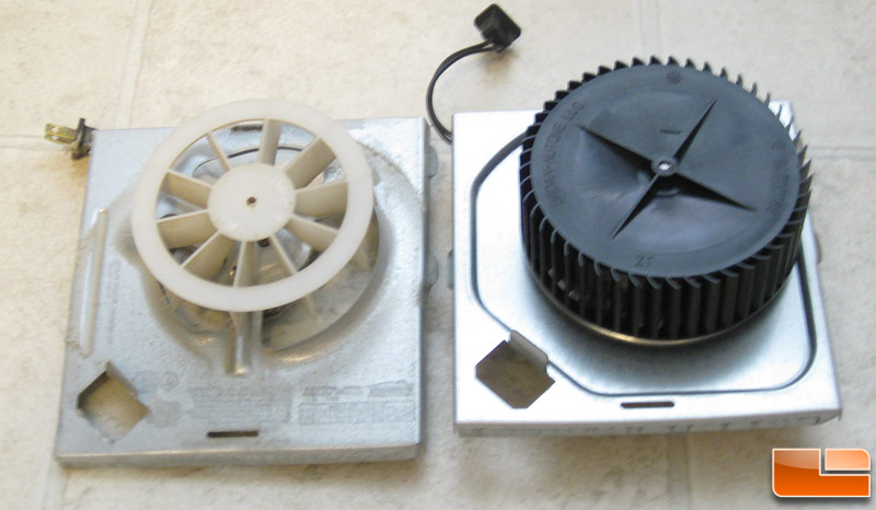

End result... The NuTone 690NT White Exhaust Fan Upgrade Kit does seem to move more air, but 10CFM more might not be enough still... When it comes to noise level... I grabbed my dBA meter and it went from 65dBA with the Broan 688 down to 61dBA... A slight decrease. Not bad difference for less than 10 minutes of work... No tools are needed other than a wrench that comes with the upgrade kit.
Just thought I'd share as this might help some fellow home owners with a simple project that might get overlooked.
Here are some pictures of the project:

My motor at the old house died in the exhaust fan. It was a newer built home, but the fan assembly hasn't been made by NuTone in over a decade. Yes, those new kits want you to cut the ceiling and wire some. I too wanted the easy way out. So, that kit you got was the same one I had. BUT ... the orifice plate was way too small. So, after some trimming of the new plate to fit into the old box and making a motor mounting strap, every thing worked really well.

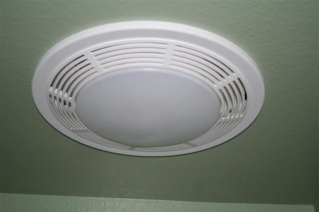

We had a dark bathroom downstairs with a small recessed light and a noisy fan. I used a sawzall to cut the nails holding the old fan housing in place, removed it, enlarged the hole a bit then installed one with a fan / light combo. Now we have two lights and it's much better. I do wish I could have found a more quiet fan though. You can hear this one running when you are upstiars.
