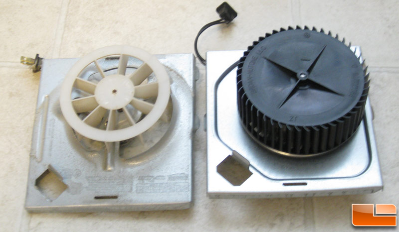

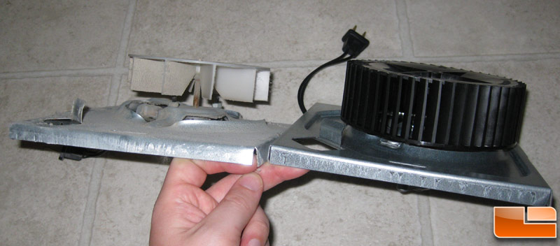

I headed up to Home Depot and while it wasn't on display they had a box on the shelf for the NuTone 690NT White Exhaust Fan Upgrade Kit... It basically is a new fan and motor that works with NuTone models 693, 695, 696N; Broan models 670, 671, 688, 689; Nautilus models N671, N688... Score one for the home team as it works with my model and costs $28 at Home Depot or $34.64 online. It is rated at 60 CFM and 3.0 Sones, so 20% more airflow and 1.0 Sones quieter. At 60 CFM this is good for bathrooms up to 50 SQFT.
End result... The NuTone 690NT White Exhaust Fan Upgrade Kit does seem to move more air, but 10CFM more might not be enough still... When it comes to noise level... I grabbed my dBA meter and it went from 65dBA with the Broan 688 down to 61dBA... A slight decrease. Not bad difference for less than 10 minutes of work... No tools are needed other than a wrench that comes with the upgrade kit.

The NuTone 690NT on the right sitting next to the original Broan 688
The NuTone 690NT is a totally different design
