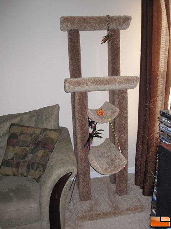

I've been working on building my cat a tree for the past month and finally got it all finished yesterday afternoon. I've never worked with carpet before, so it was a learning experience... I learned that carpet blows...
All said and done the stand has a 24"x24" base that is made out of two 3/4" pieces of plywood that were glued and screwed together. The tree has three 24" perches and one 16" perch. It stands at six feet tall from the base to the top perch. The poles are each made from a pair of 2x4's, so 8 in total were used. Some 4" lag bolts with fender washers secure the base that has been routered out so the bolts are flush and not going to damage the floor. The perches are made from 12" Sono tubes that I cut into thirds and glued together for even more support. I went with two different colors of carpet to give it some depth and a more custom look. If anyone wants more detail on how to make anything let me know and I'll give you a few tips that I learned along the way.
I looked at a few cat stands and this one is similar to this one that runs $344 plus $134 for shipping... Rather than paying $478, I figured this would be a fun project and it really was. My total investment was under $70 and I think it looks pretty good for a first attempt.
Without further ado here is a picture of it:
