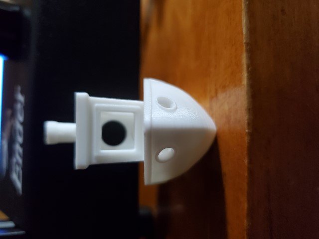

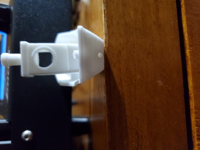

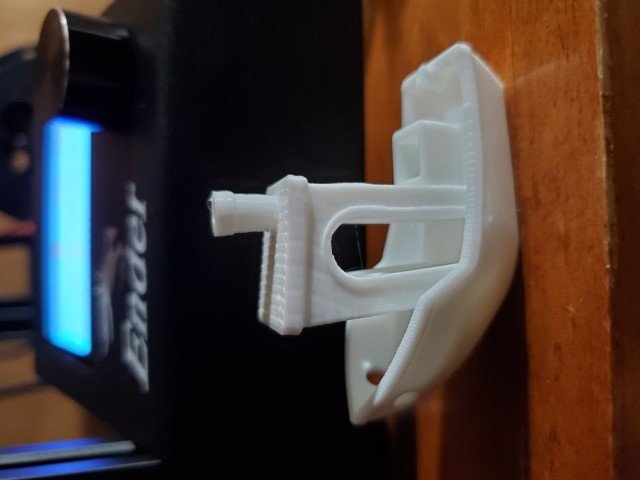

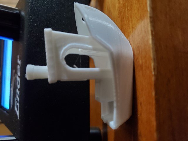

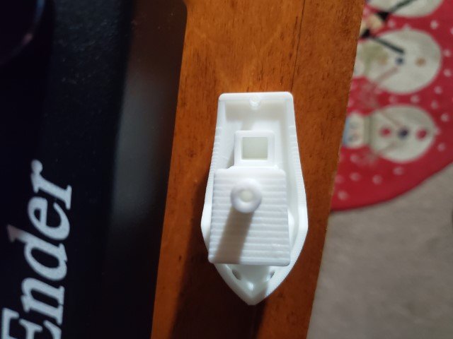

My first print - after some problems! Seems the bowden tube (correct name?) was not fully inserted into the nozzle so it built up plastic and cooled to block everything....ugh I resized all to 480 for filesize purposes.
And for some reason they are rotated....Took them with my phone rather than a real camera but should be good enough.

Don't forget the bottom. The text shows how perimeters and small gap fill looks.
Can't make out the text on the back of the boat from the small images.
over all looks good.
Now do the XZY cube and see if you are dimensionally accurate.

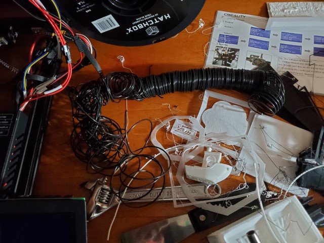

So last night I had it running and was printing good. Went to bed. This morning there is a tightly would looping of filament bunched up before the extruder (cold where the gear is to pull the filament through the bowden tube) and no indication of what the hell happened.
20191109_060841 (Small).jpg (82.47 KiB) Viewed 31264 times
Ugh so now I have to try and check to see if something got jammed or maybe the filament broke just in the right place so it didnt go in the bowden tube but around the gear.....no idea yet. Just so weird how everything started out really good and now I cant do a thing ](*,)

So it was before the bowden.. pure guess, but I would say the PLA was brittle or had a nic/score in it, that caused it to break, and the end started to curl between the feed tube and the drive gear.
If you still have the filament that was left in the bowden look at what would have been the extruder end of it. Was it a clean break?

So I took it apart last night and it seems like it was my fault (of course). I did not seem to have the bowden tube the whole way down in the hotend (where the plastic squirts out) and it left a gap between the bowden tube and the nozzle so plastic kind of built up in there and then cooled, blocking the filament and causing the backup. That is twice I have not had the bowden tube down tight (unless it is working loose somehow)...gotta remember to check that.

Yeah, don't even think of using Flexible's on a bowden setup. There are people that run dedicated setups just for it due to the needs to print the stuff.
As for the bowden tube not set against the nozzle.
heat up everything, take the nozzle off and coupling. Shove the tube through the heat break to get the throat cleaned out. Pull the tube out, put coupling back in. Put the nozzle back on, but half to full turn from tight.
Make sure the bowden tube end is clean, cut square, and not smooshed (still round). Hold the tube up to the hotend to get a feel how much is needed to get to the nozzle. They shove it in until it hits the nozzle, then give it a little more of a nudge. Now tighten up the nozzle.
