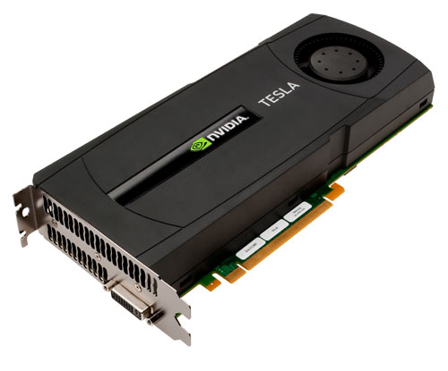

Tesla_C2050-C2070
Tesla C2050 GPU Computing Processor

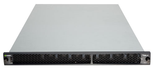

Tesla_S2070
Tesla S2070 GPU Computing System

* Tesla C2050 & C2070 GPU Computing Processors
o Single GPU PCI-Express Gen-2 cards for workstation configurations
o Up to 3GB and 6GB (respectively) on-board GDDR5 memoryi
o Double precision performance in the range of 520GFlops - 630 GFlops
* Tesla S2050 & S2070 GPU Computing Systems
o Four Tesla GPUs in a 1U system product for cluster and datacenter deployments
o Up to 12 GB and 24 GB (respectively) total system memory on board GDDR5 memoryii
o Double precision performance in the range of 2.1 TFlops - 2.5 TFlops
