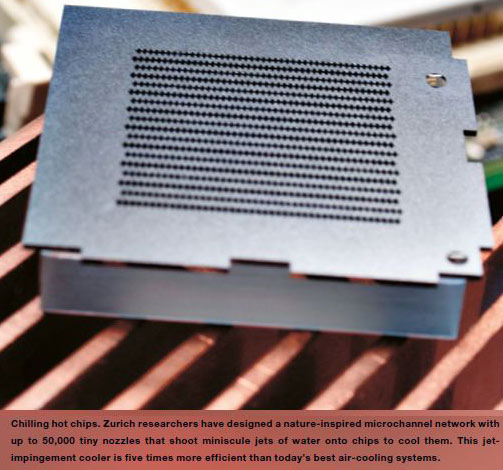

The processors and numerous other components in the new high performance computer are cooled with up to 60 degrees C warm water. This is made possible by an innovative cooling system that comprises micro-channel liquid coolers which are attached directly to the processors, where most heat is generated. With this chip-level cooling the thermal resistance between the processor and the water is reduced to the extent that even cooling water temperatures of up to 60 degrees C ensure that the operating temperatures of the processors remain well below the maximally allowed 85 degrees C. The high input temperature of the coolant results in an even higher-grade heat at the output, which in this case is up to 65 degrees C. Overall, water removes heat 4,000 times more efficiently than air.
"With Aquasar we achieved an important milestone on the way to CO2-neutral data centers," said Dr. Bruno Michel, manager of Advanced Thermal Packaging at IBM Research – Zurich. "The next step in our research is to focus on the performance and characteristics of the cooling system which will be measured with an extensive system of sensors, in order to optimize it further."
