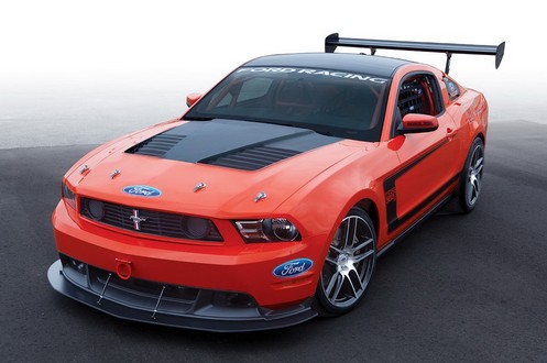

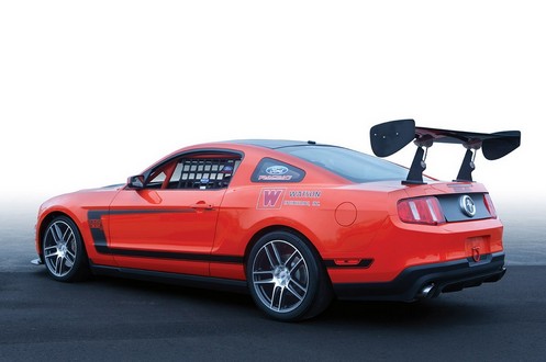

Following the Mustang Boss 302R track car, and the road-going Mustang Boss 302, now comes the Boss 302S racer. This multi-purpose race car has been developed by Ford Racing to provide enthusiasts with an affordable way to road race. The car has an MSRP of $79,000 and can be ordered at Ford Racing dealers. That’s a great price for a race car specially with such specs.
Mustang Boss 302S is powered by a tuned version of the new 5.0 liter 4-valve Ti-VCT V-8 engine and includes a 6-speed transmission sourced directly from the BOSS 302 parts bin to deliver 440 hp to the rear wheels via via a T2 Torsen differential and 3.73 gears. The BOSS 302S suspension features two-way adjustable coil-over dampers and Ford Racing anti-roll bars in both the front and rear.
The 302S is based on the production model, but it’s much lighter since the factory seam sealer, sound deadener and interior panels are deleted prior to body build. It is fitted with mandatory racing equipments such as RECARO HANS Pro-Racer lightweight race seat, 6-point safety belt, quick release steering wheel and AIM data acquisition system with GPS.
BOSS 302S aerodynamic updates include a unique fiberglass heat extracting hood, adjustable front splitter and adjustable carbon fiber rear wing. A “retro” styled BOSS 302 graphics package is included with each car and mimics the graphics from the original 1969 BOSS 302 program
Official: Mustang BOSS 302S Race Car 2012 Ford Mustang Boss 302S 2
