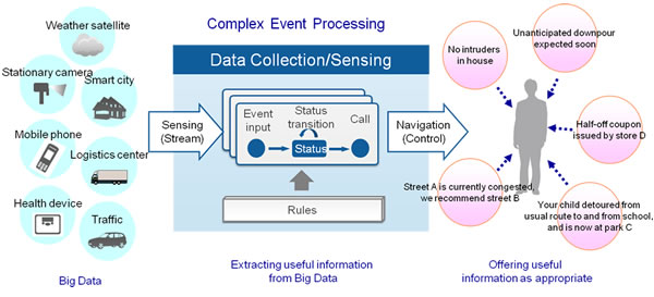

About Complex Event Processing
Complex event processing is a method for mining big data in real time to extract useful information. Methods of processing a large volume of data using a database, for which the data first need to be stored on some medium, such as a disk, are therefore not suitable for real-time processing. By contrast, as shown in Figure 1, with complex event processing, multiple inputs of time series data are processed in memory based upon pre-defined rules (known as "queries"), enabling extremely fast processing compared to methods database storage.

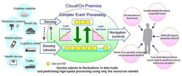

The newly developed complex event processing technology is able to dynamically apply distributed and parallel processing technology to address load variations. This technology enhances the granularity of processing and can transfer this finer processing across servers, as well as be configured based on technology that selects the optimum candidate processing to be transferred. As a result, time series data load fluctuations are adapted to swiftly, and together with entire event processing that can dynamically scale out or shrink (scale in) across servers, the processing speeds are also raised. Features of the newly developed technology are as follows.

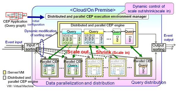

1. Distributed and parallel processing technology-based dynamic load distribution for complex event processing
As shown in Figure 2, unit-based management of complex event processing takes each query and the data parallelization of each query, and then refines it into smaller parts. As methods of dynamic load distribution, both data parallel distribution and query distribution are realized. This makes possible dynamic distribution processing in real time that can adjust to load fluctuations within a limited range of resources. In addition, in the case of processing simple queries, high-throughput of 5 million events per second was achieved.
2. Technology that optimally selects migration processing candidates depending on the status of load fluctuations
Based on the speed of load fluctuations, the properties of each event or query, or the status of the processing load, Fujitsu developed technology that enables the effective distribution of loads and that migrates processing tasks for which the impact of the migration is lowest. As an example, queries that are closely related are, to the extent possible, allocated in the same server, enabling the maintenance of high-speed processing.

The new technology, which will support the creation of human-centric computing in which fine-grained services are offered in all areas of daily life, makes it possible when processing big data to maintain high processing performance and accommodate fluctuations in processing loads without pausing the processing operations. As a result, as illustrated in Figure 3, it will be possible to develop services that provide non-stop analysis—in real time and using only the necessary resources—of the large-scale time series data by leveraging in-house facility (on-premise) systems. In addition, given the flexibility to flexibly alter configurations, the need for strict estimates of the resources is eliminated and will be accessible for even small-scale operations.
