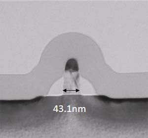

SuVolta’s DDC transistor
Figure 1. Cross-section of DDC transistor
An implementation of SuVolta’s DDC transistor on Fujitsu Semiconductor’s low-power CMOS process is shown in figure 1. The cross sectional transmission electron micrograph (TEM) shows the transistor fabricated on a planar bulk silicon structure.

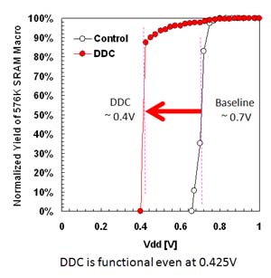

Reduction of minimum operating voltage for SRAM
Figure 2. Functional yield of 576k SRAM macro
For most chips, lowering supply voltage is limited by the SRAM. Fujitsu Semiconductor and SuVolta have demonstrated an SRAM macro functional even at 0.425V, as seen in figure 2. Since SRAM is the most challenging circuit for supply voltage reduction, the verification implies that DDC could enable approximately 0.4V operation across a variety of CMOS-based circuits.
Figure 2 shows yield of 576k SRAM macro as a function of supply voltage. The yield is calculated by counting macros in which all bits have passed.
