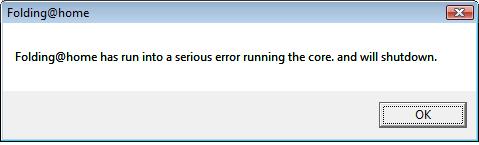

Think I might have wounded a GeForce GTX 280 graphics card by folding for nearly 72 hours non-stop... The card with default clock settings returns this:
When I look into the log file I get this... What the heck could be going on?

Re: GeForce GTX 280 Stopped Folding - Serious Error
well I restarted the machine... same error...
un-installed the F@H GPU2 software and re-installed it and now it is up and running again... Let's see how it does... That error scared the crap out of me...

Well i had heard that the GPU2 client errors every 4 days and needs to be restarted, but i don't think they quite meant having to re-install everything.
What are the temps like on the GTX?
Dan
high 60's/low 70's, but I manually set the fan to run at 70%

I presume further back on the log it was folding fine (i.e. at the normal time per step) just before it started throwing the "mdrun_gpu returned -1" errors?

DMB2000uk wrote:Well i had heard that the GPU2 client errors every 4 days and needs to be restarted, but i don't think they quite meant having to re-install everything.
Dan
I havent had to restart mine at all, I just have problems when they try to send updates.
overclocked to 650/1625/971 I keep mine at around 60C with rivatuner usually having the fan 60% below 60C and 80% at 60-like68 or something, then 100 :)
I DID have trouble with the regular nvidia drivers, but once I installed the CUDA drivers and stuff, it has worked fine. Are you using the CUDA or the regular drivers?
Maybe if it happens again, try the other driver set and see how it works.
Mike
the official cuda drivers 177.35 and GPU2 v6 beta 8
