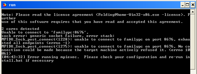

Installed the MPICH client and I'm getting this. I'm too tired to even try to figure it out.

Been trying to help him out through AIM and I'm completely stumped...I walked him through setting up shortcuts (one with -configonly flag one with -smp ) and the config went fine. He errors out when trying to run though. Only thing I can think is that it might have something to do with him installing on XP 32bit or with him previously trying to install deino...either that or a PEBKAC :roll:

i get that same error, so i just run the SMP program, but from the original program, not the shortcut and fold with text-only console on the other core, all im getting is amber cores anyway

Try to delete all temp. files and reboot. Start over, Follow instructions, don't miss a step or it will not work. Copy and paste, makes it easier. Make sure you set the right amount of cores for your rig.

I never saw ANY option as to how many cores o.o
As you can see, it shows 2... ugh. On the not-so-terrible side of things, all my completed WU's aren't showing up on EOC, so at least I'm not pulling my hair out over 2 machines not sending their work in.
Going to delete all that stuff again and start over. What a pain!

Collection server: 171.65.103.100
Download date: September 30 16:36:23
Finished date: September 30 20:32:16
Slot 01 Empty/Deleted
Project: 4418 (Run 49, Clone 10, Gen 71), Core: 81
Work server: 171.64.122.72:8080
Collection server: 171.64.122.76
Download date: September 30 20:33:27
Finished date: September 30 22:16:00
Slot 02 Empty/Deleted
Project: 4423 (Run 15, Clone 13, Gen 69), Core: 81
Download date: September 30 22:18:12
Finished date: September 30 23:56:00
Slot 03 Empty/Deleted
Project: 4421 (Run 13, Clone 12, Gen 65), Core: 81
Download date: September 30 23:59:23
Finished date: October 1 01:38:11
Slot 04 Empty/Deleted
Project: 4426 (Run 27, Clone 8, Gen 29), Core: 81
Download date: October 1 01:39:26
Finished date: October 1 06:07:07
Slot 05 Empty/Deleted
Project: 2606 (Run 88, Clone 10, Gen 96), Core: 78
Work server: 171.64.65.65:8080
Collection server: 171.64.122.86
Download date: October 1 06:09:26
Finished date: October 1 13:35:22
Failed uploads: 1
Slot 06 Empty/Deleted
Project: 2613 (Run 65, Clone 0, Gen 73), Core: 78
Download date: October 1 13:36:59
Finished date: October 2 22:16:13
Failed uploads: 2
Slot 07 *Done
Project: 5113 (Run 38, Clone 73, Gen 2), Core: a0
Work server: 171.64.122.42:8080
Download date: October 2 22:16:21
Finished date: October 4 02:47:01
Failed uploads: 3
PF: 0.982405 based on last 4 slot(s)
GPU Queue:
[03:09:55] Finished Work Unit:
[03:09:55] - Reading up to 34800 from "work/wudata_09.trr": Read 34800
[03:09:55] trr file hash check passed.
[03:09:55] - Reading up to 1129020 from "work/wudata_09.xtc": Read 1129020
[03:09:55] xtc file hash check passed.
[03:09:55] edr file hash check passed.
[03:09:55] logfile size: 133163
[03:09:55] Leaving Run
[03:09:56] - Writing 1298055 bytes of core data to disk...
[03:09:57] Done: 1297543 -> 1158397 (compressed to 89.2 percent)
[03:09:57] ... Done.
[03:09:57] - Shutting down core
[03:09:57]
[03:09:57] Folding@home Core Shutdown: FINISHED_UNIT
[03:10:00] CoreStatus = 64 (100)
[03:10:00] Sending work to server
[03:10:00] Project: 5016 (Run 5, Clone 152, Gen 117)
[03:10:00] - Read packet limit of 540015616... Set to 524286976.
[03:10:00] + Attempting to send results [October 4 03:10:00 UTC]
[03:10:00] - Couldn't send HTTP request to server
[03:10:00] + Could not connect to Work Server (results)
[03:10:00] (171.64.65.20:80)
[03:10:00] + Retrying using alternative port
[03:10:00] (171.64.65.20:8080)
[03:10:00] - Error: Could not transmit unit 09 (completed October 4) to work server.
[03:10:00] Keeping unit 09 in queue.
[03:10:00] (171.64.122.86:80)
[03:10:00] (171.64.122.86:8080)
[03:10:00] Could not transmit unit 09 to Collection server; keeping in queue.
[03:10:00] - Preparing to get new work unit...
[03:10:00] + Attempting to get work packet
[03:10:00] - Connecting to assignment server
[03:10:15] + Could not connect to Assignment Server
[03:10:30] + Could not connect to Assignment Server 2
[03:10:30] + Couldn't get work instructions.
[03:10:30] - Attempt #1 to get work failed, and no other work to do.
Waiting before retry.
[03:10:37] + Attempting to get work packet
[03:10:37] - Connecting to assignment server
[03:10:52] + Could not connect to Assignment Server
[03:11:07] + Could not connect to Assignment Server 2
[03:11:07] + Couldn't get work instructions.
[03:11:07] - Attempt #2 to get work failed, and no other work to do.
[03:11:26] + Attempting to get work packet
[03:11:26] - Connecting to assignment server
[03:11:41] + Could not connect to Assignment Server
[03:11:56] + Could not connect to Assignment Server 2
[03:11:56] + Couldn't get work instructions.
[03:11:56] - Attempt #3 to get work failed, and no other work to do.
[03:12:17] + Attempting to get work packet
[03:12:17] - Connecting to assignment server
[03:12:32] + Could not connect to Assignment Server
[03:12:47] + Could not connect to Assignment Server 2
[03:12:47] + Couldn't get work instructions.
[03:12:47] - Attempt #4 to get work failed, and no other work to do.
[03:13:36] + Attempting to get work packet
[03:13:36] - Connecting to assignment server
[03:13:51] + Could not connect to Assignment Server
[03:14:06] + Could not connect to Assignment Server 2
[03:14:06] + Couldn't get work instructions.
[03:14:06] - Attempt #5 to get work failed, and no other work to do.
[03:15:32] + Attempting to get work packet
[03:15:32] - Connecting to assignment server
[03:15:47] + Could not connect to Assignment Server
[03:16:02] + Could not connect to Assignment Server 2
[03:16:02] + Couldn't get work instructions.
[03:16:02] - Attempt #6 to get work failed, and no other work to do.
[03:18:44] + Attempting to get work packet
[03:18:44] - Connecting to assignment server
[03:18:59] + Could not connect to Assignment Server
[03:19:14] + Could not connect to Assignment Server 2
[03:19:14] + Couldn't get work instructions.
[03:19:14] - Attempt #7 to get work failed, and no other work to do.
[03:24:40] + Attempting to get work packet
[03:24:40] - Connecting to assignment server
[03:24:55] + Could not connect to Assignment Server
[03:25:10] + Could not connect to Assignment Server 2
[03:25:10] + Couldn't get work instructions.
[03:25:10] - Attempt #8 to get work failed, and no other work to do.
[03:36:00] + Attempting to get work packet
[03:36:00] - Connecting to assignment server
[03:36:15] + Could not connect to Assignment Server
[03:36:30] + Could not connect to Assignment Server 2
[03:36:30] + Couldn't get work instructions.
[03:36:30] - Attempt #9 to get work failed, and no other work to do.
[03:58:00] + Attempting to get work packet
[03:58:00] - Connecting to assignment server
[03:58:15] + Could not connect to Assignment Server
[03:58:30] + Could not connect to Assignment Server 2
[03:58:30] + Couldn't get work instructions.
[03:58:30] - Attempt #10 to get work failed, and no other work to do.
[04:41:13] + Attempting to get work packet
[04:41:13] - Connecting to assignment server
[04:41:28] + Could not connect to Assignment Server
[04:41:43] + Could not connect to Assignment Server 2
[04:41:43] + Couldn't get work instructions.
[04:41:43] - Attempt #11 to get work failed, and no other work to do.
[05:27:00] Project: 5016 (Run 5, Clone 152, Gen 117)
[05:27:00] - Read packet limit of 540015616... Set to 524286976.
[05:27:00] + Attempting to send results [October 4 05:27:00 UTC]
[05:27:07] + Results successfully sent
[05:27:07] Thank you for your contribution to Folding@Home.
[05:27:07] + Number of Units Completed: 215
[05:29:53] + Attempting to get work packet
[05:29:53] - Connecting to assignment server
[05:29:53] - Successful: assigned to (171.64.65.106).
[05:29:53] + News From Folding@Home: GPU folding beta
[05:29:53] Loaded queue successfully.
[05:29:54] + Closed connections
[05:29:54]
[05:29:54] + Processing work unit
[05:29:54] Core required: FahCore_11.exe
[05:29:54] Core found.
[05:29:54] Working on queue slot 00 [October 4 05:29:54 UTC]
[05:29:54] + Working ...
[05:29:54]
[05:29:54] *------------------------------*
[05:29:54] Folding@Home GPU Core - Beta
[05:29:54] Version 1.09 (Fri Aug 1 11:46:54 PDT 2008)
[05:29:54]
[05:29:54] Compiler : Microsoft (R) 32-bit C/C++ Optimizing Compiler Version 14.00.50727.762 for 80x86
[05:29:54] Build host: amoeba
[05:29:54] Board Type: Nvidia
[05:29:54] Core :
[05:29:54] Preparing to commence simulation
[05:29:54] - Looking at optimizations...
[05:29:54] - Created dyn
[05:29:54] - Files status OK
[05:29:54] - Expanded 45471 -> 246249 (decompressed 541.5 percent)
[05:29:54] Called DecompressByteArray: compressed_data_size=45471 data_size=246249, decompressed_data_size=246249 diff=0
[05:29:54] - Digital signature verified
[05:29:55]
[05:29:55] Project: 5506 (Run 6, Clone 309, Gen 119)
[05:29:55]
[05:29:55] Assembly optimizations on if available.
[05:29:55] Entering M.D.
[05:30:01] Working on p5506_supervillin_e1
[05:30:01] Client config found, loading data.
[05:30:02] Starting GUI Server
[05:31:17] Completed 1%
[05:31:35] Printing Queue Information
Current Queue:
Project: 5013 (Run 0, Clone 101, Gen 75), Core: 11
Work server: 171.64.65.20:8080
Download date: October 1 22:32:01
Finished date: October 2 00:55:56
Project: 5014 (Run 2, Clone 200, Gen 91), Core: 11
Download date: October 2 00:56:11
Finished date: October 2 05:50:34
Project: 5014 (Run 6, Clone 320, Gen 27), Core: 11
Download date: October 2 06:05:51
Finished date: October 2 08:24:32
Failed uploads: 4
Project: 5013 (Run 5, Clone 204, Gen 91), Core: 11
Download date: October 2 19:39:45
Finished date: October 2 22:02:12
Failed uploads: 2
Project: 5015 (Run 4, Clone 729, Gen 124), Core: 11
Download date: October 2 22:17:09
Finished date: October 3 00:34:53
Failed uploads: 2
Project: 5014 (Run 0, Clone 185, Gen 80), Core: 11
Download date: October 3 03:43:41
Finished date: October 3 06:11:35
Failed uploads: 2
Slot 07 Empty/Deleted
Project: 5016 (Run 7, Clone 300, Gen 80), Core: 11
Download date: October 3 12:34:59
Finished date: October 3 15:50:39
Failed uploads: 3
Slot 08 Empty/Deleted
Project: 5014 (Run 0, Clone 201, Gen 67), Core: 11
Download date: October 3 22:14:03
Finished date: October 4 00:40:39
Failed uploads: 2
Slot 09 Empty/Deleted
Project: 5016 (Run 5, Clone 152, Gen 117), Core: 11
Download date: October 4 00:49:47
Finished date: October 4 03:10:00
Failed uploads: 2
Slot 00 *Active
Project: 5506 (Run 6, Clone 309, Gen 119), Core: 11
Work server: 171.64.65.106:8080
Download date: October 4 05:29:54
Deadline date: October 7 05:29:54
PF: 0.963440 based on last 4 slot(s)
[05:32:34] Completed 2%
Cyberpower generic case
B450M PRO-VDH MAX
Ryzen 5 3600 w/PBO/OC
CM Hyper 212 EVO push/pull
Samsung 970 EVO Plus 500GB
6GB Seagate HDD
EVGA 650BQ 650W PSU
MS LXM-00001 keyboard
DaIceMan
Posts: 1599
Joined: Tue Jul 18, 2006 10:31 pm
Location: Springfield-ish, Missouri
Re: E7200 SMP question
Post by DaIceMan »
CPU is trying to get work for Slot 8, and has a finished unit in Slot 7.
[05:26:50] + Attempting to send results [October 4 05:26:50 UTC]
[05:28:06] - Couldn't send HTTP request to server
[05:28:06] + Could not connect to Work Server (results)
[05:28:06] (171.64.122.42:8080)
[05:28:06] + Retrying using alternative port
[05:28:07] - Couldn't send HTTP request to server
[05:28:07] + Could not connect to Work Server (results)
[05:28:07] (171.64.122.42:80)
[05:28:07] - Error: Could not transmit unit 07 (completed October 4) to work server.
[05:28:07] - Read packet limit of 540015616... Set to 524286976.
http://foldingforum.org/viewtopic.php?f ... &sk=t&sd=a
GPU

skier
Posts: 4450
Location: Maine
Post by skier »
back to the SMP question, as i also had(please accept license agreement), i deleted all the files i could, then reinstalled using this guide, now it goes good
-Austin
