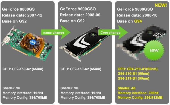

Looks like Nvidia is at it again with the product and name change guessing game. I need to find my damned secret decoder ring to figure this out. :evil:
http://en.expreview.com/2008/10/08/1049.html
Just to recap, those of you planning to buy a 9600 GSO for its folding performance will have to pay special attention shortly, the new (neutered) card has not made it to the market...yet.
Nvidia needs to figure out a naming system which signifies performance to the everyman, not just those who have hours to pour over the charts here on Legit Reviews. Intel does it, AMD does it, AMD does it for their video cards, how hard is it Nvidia?
I HIGHLY doubt that more than 1 or 2 sites would have gotten a sample of the new card to compare to the old...if they even bothered to send samples.
They also need to stop trying to dupe customers into buying less performance at the same name and price when they see that a nearly forgotten product suddenly starts flying off the shelves due to a niche use (incredible folding performance per dollar).
Sorry for the rant but this is just BS.

Check that..... I'm hearing that a member of another forum may have gotten one or two of these in a recent purchase. Make sure you do your home work, the new one is putting out around 2500 ppd vs. 5000+ for the original 9600 GSO.

The only way I can seem to find is the memory configuration.

I dunno, this sure looks like one to me considering the memory size and width.
http://www.newegg.com/Product/Product.a ... 6814121255

Bwall wrote:I dunno, this sure looks like one to me considering the memory size and width.
Look at the specs: Stream Processors - 96
Nah, I'm good. Nate's right. I have two of these bad boys.

No... look at the memory. You don't have 512mb on a 192bit-wide interface. Newegg simply got the # of shaders wrong, they DO get minor spec details wrong as I've seen this plenty of times before.
What is interesting is that card is listed as 128bit memory interface... NOT 256bit as indicated in the image. So it is even more hobbled.... No one in their right mind would want a 512mb card with a 128bit interface. Assuming it actually had the shader power to use it, 48 shaders is nothing. It's just another 8600GTS, slightly more shaders and slightly less memory bandwidth.

You can't create something that isn't there. G94 only comes with 64 shaders in it's entirety. Same story with the memory bus, you can't use something that isn't there.

See, that's the bad thing about this... we have no idea if that is an "original" or not. It doesn't look like it due to the memory specs but people on another forum think it's ok.
I guess the best advice is to stay away from anything other than 384MB or 768MB cards with 192-bit bus.
