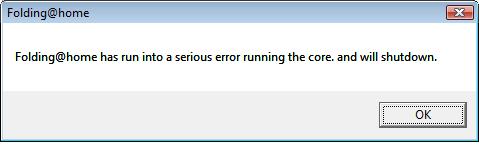

Think I might have wounded a GeForce GTX 280 graphics card by folding for nearly 72 hours non-stop... The card with default clock settings returns this:
When I look into the log file I get this... What the heck could be going on?

[14:45:39] Folding@home Core Shutdown: UNSTABLE_MACHINE
[14:45:43] CoreStatus = 7A (122)
[14:45:43] Client-core communications error: ERROR 0x7a
[14:45:43] This is a sign of more serious problems, shutting down.
Re: GeForce GTX 280 Stopped Folding - Serious Error
Posted: Sat Jul 12, 2008 5:09 pm
by Apoptosis
well I restarted the machine... same error...
un-installed the F@H GPU2 software and re-installed it and now it is up and running again... Let's see how it does... That error scared the crap out of me...
