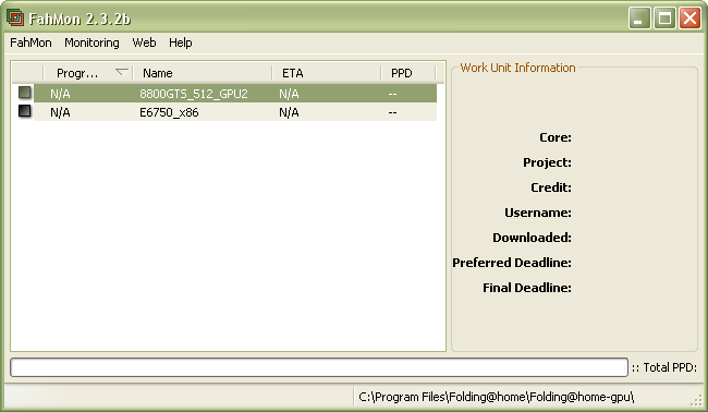

So I installed FAHmon yesterday just out of curiosity, and set it up according to a walkthrough, and I'm not seeing squat.
Do I have an issue or should I just be patient and let it do it's thing?

Black means that fahmon can't see the folding clients. You linked to the correct directory (I think its the one with your logs)?
Short of that, the clients are both running aren't they?
(that should make fahmon have a red box, but you never know with it being first time)

you can see from the bottom of the picture his path is wrong, select the work directory

stopthekilling, FAhmon can take up to 3 frames before it registers change, so once you change directories, don't be surprised if nothing changes

STK... in XP, the work path for the GPU install is;
C:\Documents and Settings\DaIceMan\Application Data\Folding@home-gpu
What client is the 6750 using? is it the x86 with viewer or without? If it's with viewer, I believe it auto installs like the GPU client. Without viewer, I think you have to manually extract and run from there so the path would be diff. Let me know which client it is and I'll install it to find the correct path for you.
